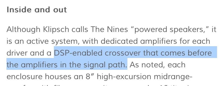

These are DSP speakers, so they are converting your Cyan2’s anlogue output back to PCM before converting to analogue yet again.
14900K CPU + RTX 4090 GPU is consuming a lot of power, only for it to end back to PCM :cry:
Probably a Raspberry Pi4 running HQP OS is sufficient to feed DSP speakers 2ch
Nothing wrong with DSP speakers - I have DIY 8ch that I feed PCM from HQPlayer. HQP handles the upsampling and the room correction. But I definitely wouldn’t double-DAC them.
Of course, you can turn off the dsp and use the external dac directly. Internal dac enabled only via usb. You can select the line setting from behind.
Since it has DSP crossover, it will always end up either PCM96kHz or PCM192kHz
There is no DSP crossover on the planet operating at DSD256 or higher, unless it is a DIY one like I have.
For true analogue passthrough, there would be need to be an analogue crossover inside and there is not. It is DSP crossover.
There are two analog inputs: one L/R pair on RCA and a 1/8" (3.5mm) stereo miniplug. The RCA inputs are switchable, for a line-level source or a turntable, which connects with the built-in MM phono preamp
I understand. There are many DSP speakers with analogue inputs. And when they have a DSP crossover, they must convert analogue to PCM.
As mentioned above, for true analogue passthrough, there would be need to be an analogue active crossover inside and there is not. It is DSP crossover.
My office KEF LS50W2 have analogue input - i would never feed these DSD256 from Cyan2, given the above is all true for my KEFs too.
F***… I search and buy new ones today.
LOL not essential ! Simply feed them PCM96/192 from HQP ! Like I do with my KEF LS50W2.

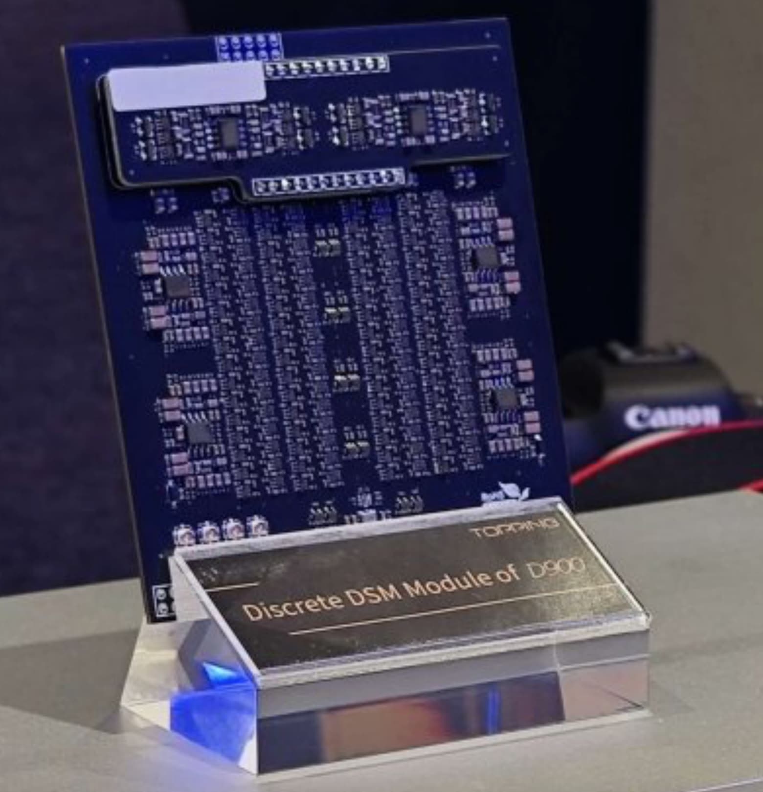

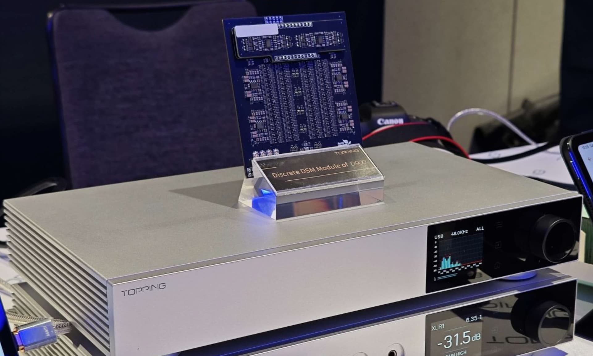

All the complaints about Topping’s AKM + DSDD implementation and now we have this coming
Unknown if it will have a true DSD bypass mode though, to bypass any internal DSP.
If it has true DSP bypass mode… Watch this space :smile:
DSM is not DSD. I’m confused why there are so many resistors on that board if you want true DSD (1-bit). :slight_smile:
But, I don’t do hardware design.
