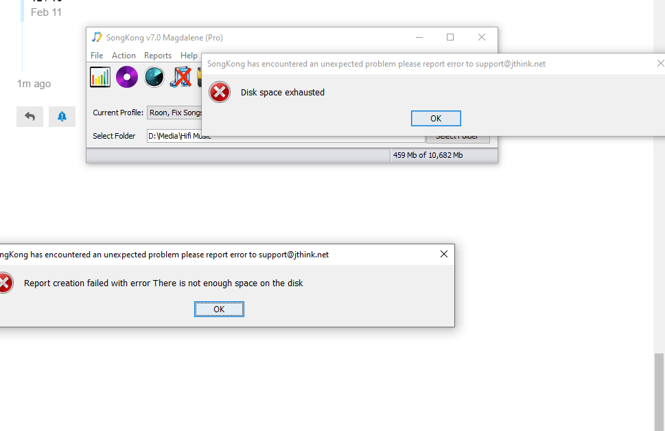

I had it run again and it completed about 11k songs and said I ran out of disk space. It’s on my C: drive where it shows 800mb of disk space free now. I’m showing its using over 80GB of space. Roon backup is showing another 80GB(unsure if that’s related or not). Not sure where all of this space went or why when the files are on my storage spaces pool. The Users folder Sure I can send support files. Where do I pull those from and where can I send them to?
Internal database can get large and is stored in C:\users*username\AppData\Roaming\SongKong\Database*, run File:Empty Database it has no effect on your actual music files only used during the run.
You can remap to a different location on Windows
database.mv.db is over 80GB so far. Is this some backup feature or something I need? Or can I specify for this database to be on my storage pool drive?
okay I think you need to remap database to different location - How to move SongKong Database to a different location in Windows - SongKong Faq - SongKong and Jaikoz Music Tagger Community Forum
