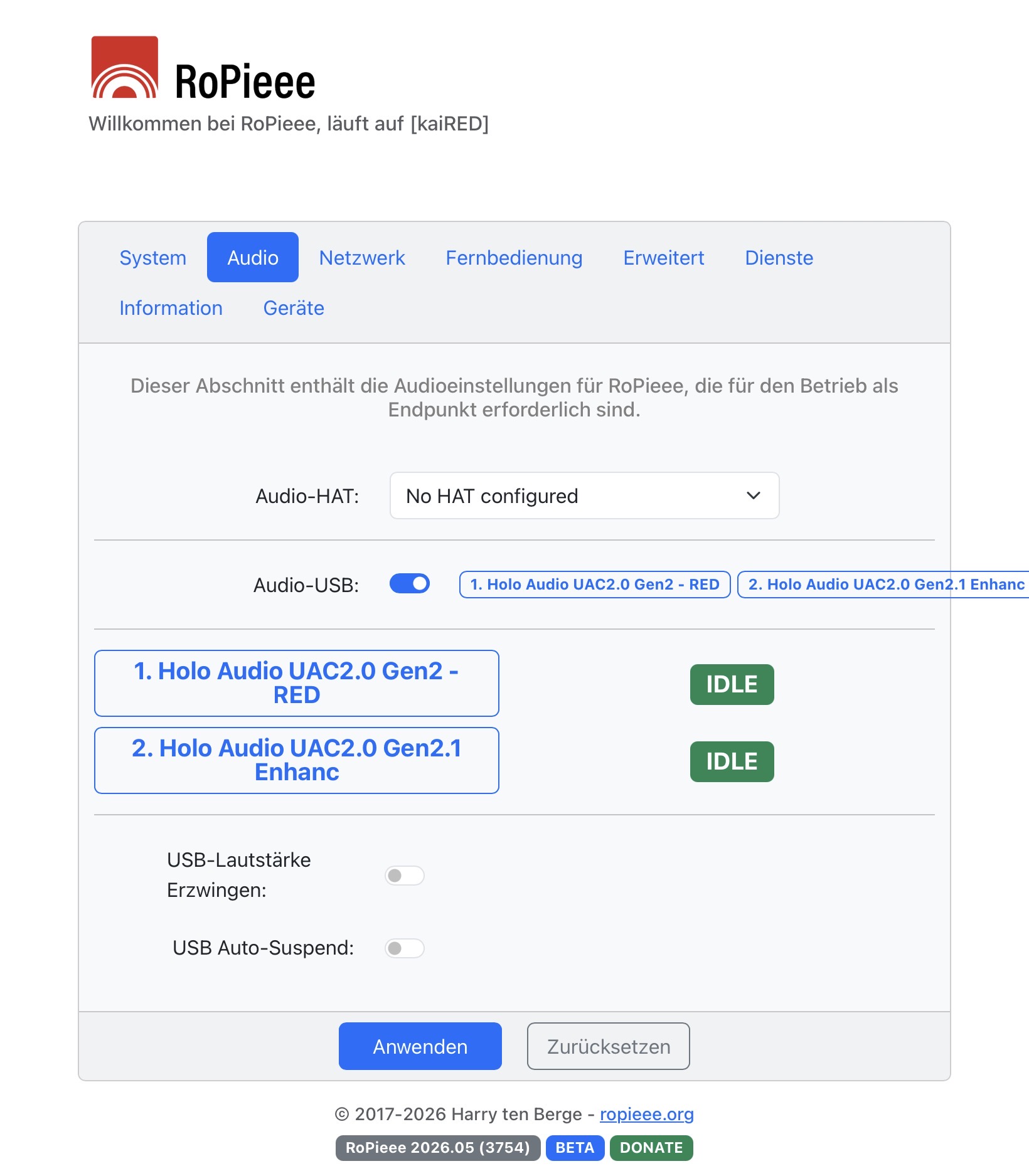

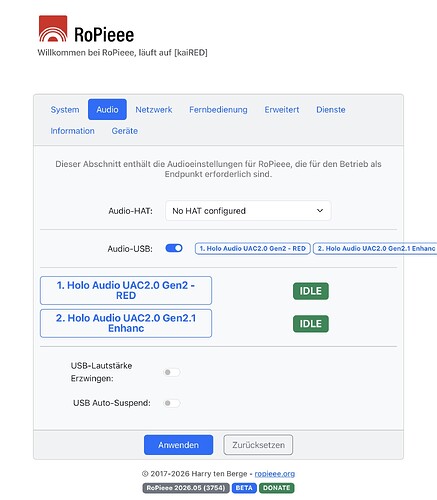

Out of curiosity: how does the RED ‘shows itself’ on RoPieee? As a single USB device or do you have 2 devices visible on the audio tab?
Two devices.

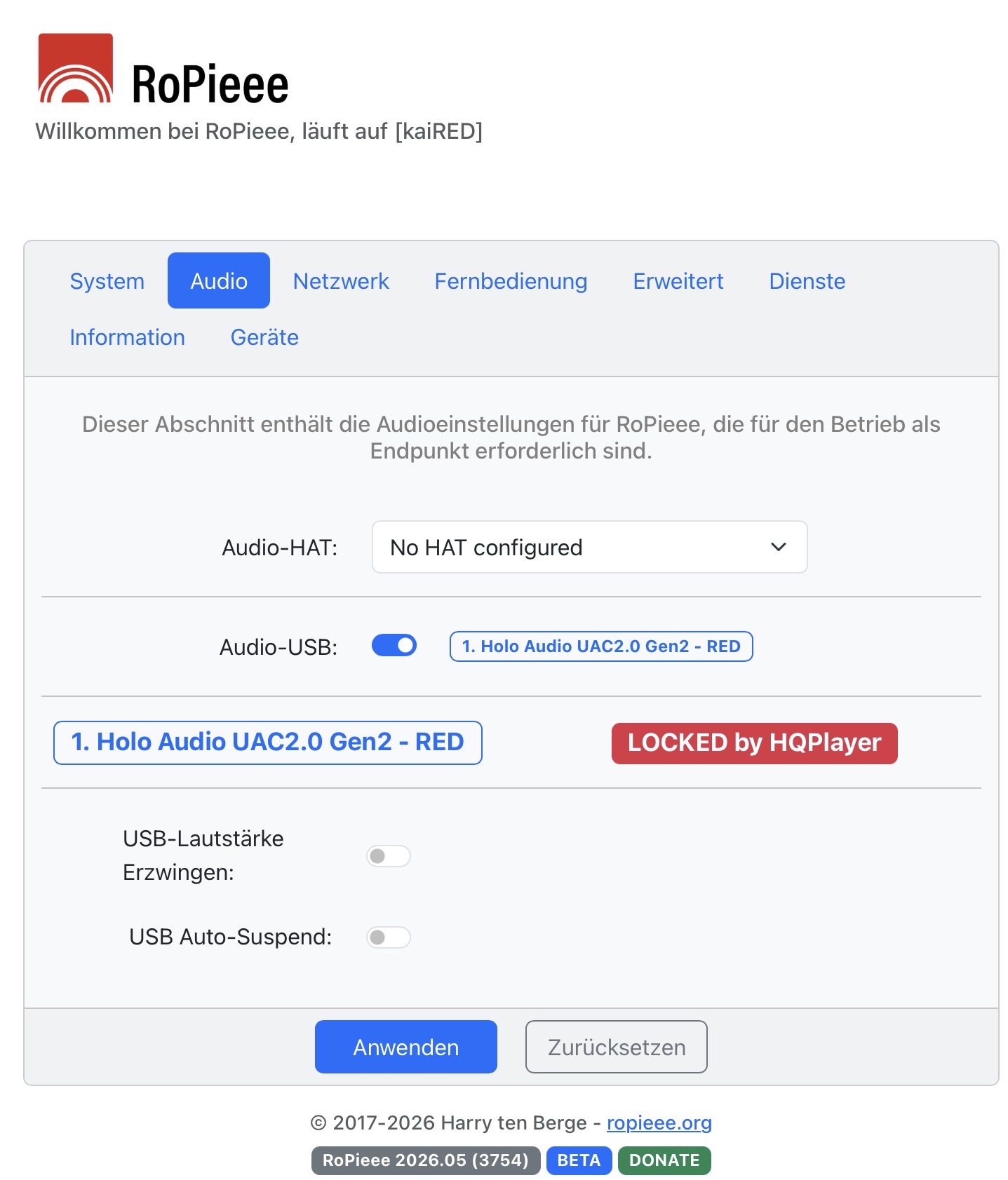

If I use USB, it shows both devices, and shows locked by the program I use.
Then I2S is used, it shows only one device.
UAC2.0 Gen2 = I2S
UAC2.0 Gen2.1 = USB

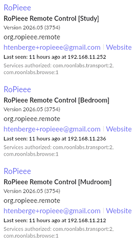

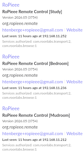

Hey Harry, I’ve been updating all of my devices to the latest beta and no new issues but I’m still seeing the extensions all disappearing from Roon at some stage (previously mentioned on the May beta). It’s not a major issue, but it’s odd that it happens to all of them at much the same time/uptime. Music continues fine, it’s just the extension that loses connection.
** EDIT: Whatever is causing it, it’s fixed by an endpoint restart but it’s not fixed by a touchui restart.

Sure thing. Here’s one of them still not showing the extension (and I haven’t rebooted it).
64e0e13ed9edb407

Hi Harry,
Yes I’ve tried rebooting Roon (with no change, the extensions that are broken don’t fix and the ones that are working don’t break).
The only thing that fixes it so far is rebooting each endpoint (I have tried restarting the touchui service but it doesn’t help, not sure if there are others I should try).
Thanks
No, the touchui is not involved. There’s only the ropieee-remote, which is the extension.
Ok. Apologies, I’ve been restarting the wrong thing. I’ll try restarting the remote next time it occurs. (Presumably on the latest beta rather than this one
