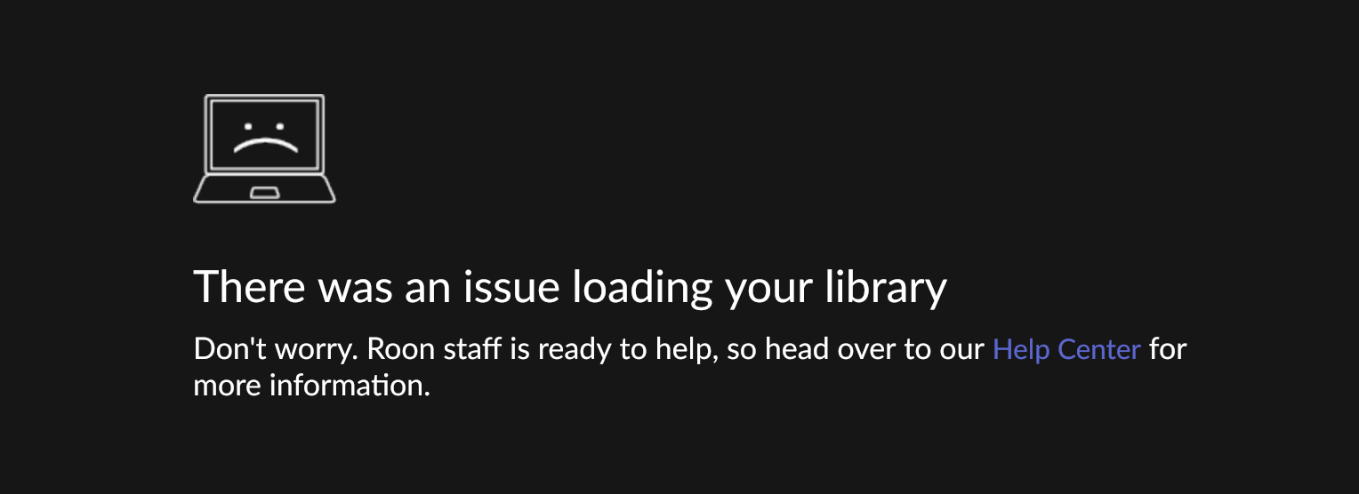

Black Screen with Issue Loading Library (ref#1YNJKJ)
· Black Screen stating, There is an issue loading your library

Hello @RTaylor3rd
Errors like the one you’ve seen now are signs of low level corruption in the database. This means that the records Roon is reading from your database are different from what was originally written. This can happen for a number of reasons, like failing hard drives or an unstable power source (frequent outages, hard power cuts, etc).
We’re sorry you’re experiencing this extremely rare error: not only is our database infrastructure designed specifically to prevent this type of corruption, but starting with Build 880, Roon detects database corruption “on the fly”. So if corruption is detected during a backup or during normal use of Roon, you’ll be immediately prompted to restore from a backup.
What’s Next?
Install Roon fresh on your Roon Server machine and roll back to one of your older backups. You can use these instructions to do so:
  • Stop RoonServer from running in Nucleus’s WebUI
  • Navigate to your Nucleus’ Database Location
  • Find the folder that says “RoonServer”
  • Rename the “RoonServer” folder to “RoonServer_old”
  • Restart the RoonServer in the WebUI to generate a new Database
  • On the Roon Remotes, press “Use another Roon Server” and connect to the new database
  • (Optional) - Restore your database from a Backup prior to the issue starting
If the database loads properly, your edits, playlists, tags, etc should be intact, and we can confirm everything is performing properly once it’s been restored.
If you do not have any backups, unfortunately the only other solution is to start with a fresh database.
