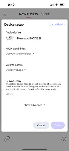

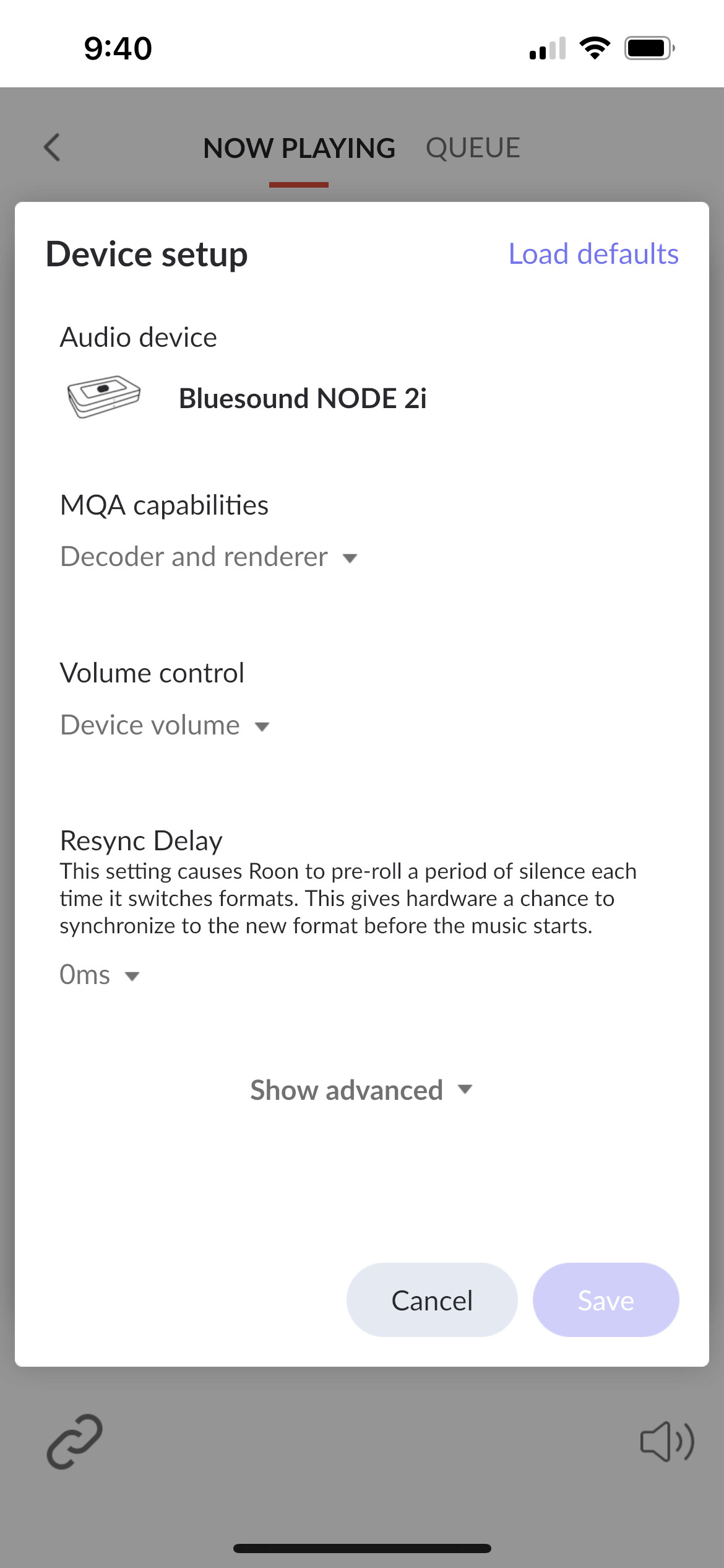

Yes. I’ve flipped multiple options to try and diagnose. This is the setup in question.

Both nodes have identical configs. In blueos config: Replay gain disabled. No external mqa dac. I am playing to external non mqa external dac. The lack of mqa “unfolding” is evidenced by bit rate Eg 88.2 v 44.1 etc. Latest firmware. I alternate between the analog out and the external topping dac out.
In Roon. Only the first node in the group of 2 decodes. If I set master clock priority to highest for any one, that takes the mqa decoding. If both are at one, back to the first.

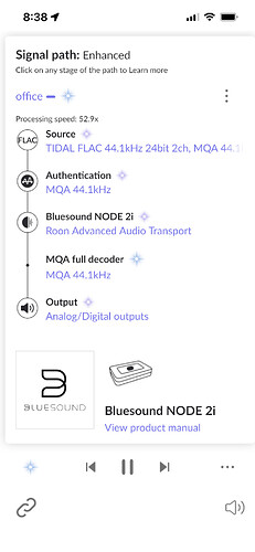

Update the issue only occurs if the node is given any mqa duties. If using the core decoder, and disabling mqa on device setup in roon, signal path reflects end to end mqa.
