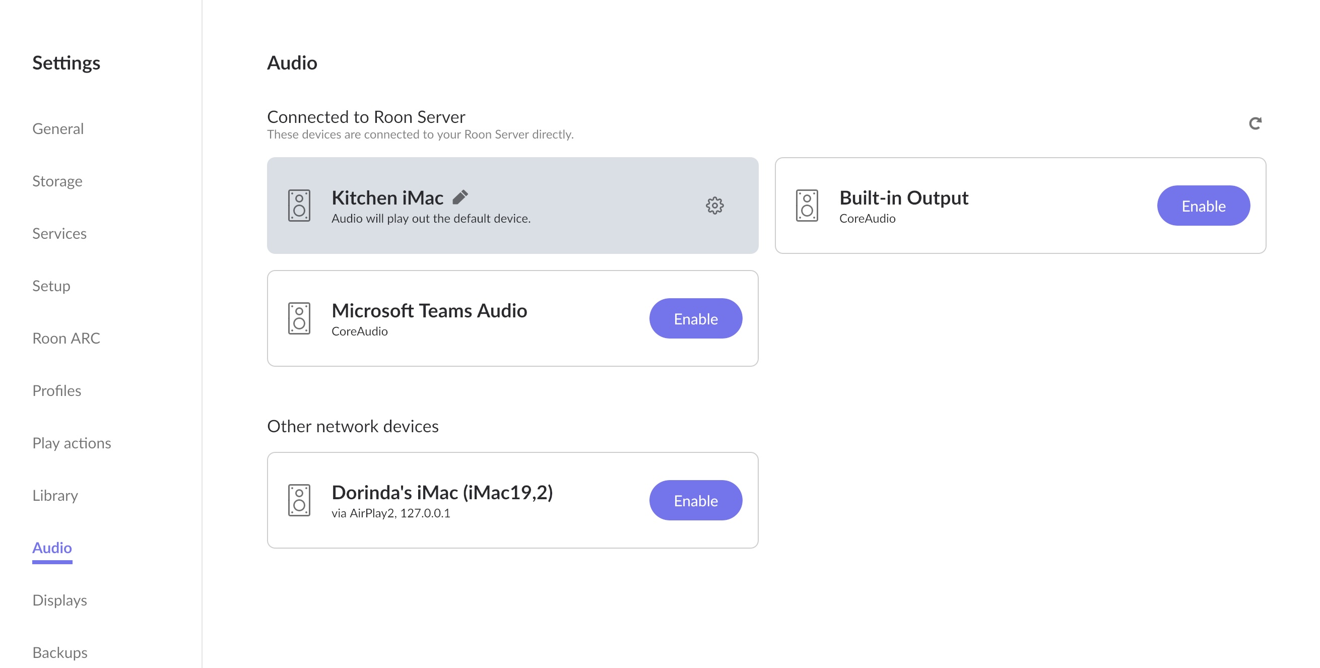

I am working with BluSound to try to get my Node 2i visible by Roon again. It has not worked in 2 weeks and my Roon subscription is wxpensive and worthless without this working. I followed BluOS suppport instructions to turn everything off my network and deliver all new IP addresses all around and the Roon still does not see the BluSound even though I can see it on rhe network with all BluOS devices and all Airplay devices,
Please help!!
Router is from Verizon, network switch from Netgear, a lot of ethernet connections. There is a Apple Extreme extender on network too. Bluesound is on ethernet as is Mac where Roon is resident.
What are the ip addresses of the Roon Server and the BluSound Node? Are they in the same subnet (first three number of the four number ip address the same)?
In your screen shot, there is something strange visible. Under ‘Connected to Roon Server’, you have the device named ‘Kitchen iMac’ which appears to be the machine running the Roon Server. Then in ‘Other network devices’ is show Droinda’s iMac via airplay - but the ip address shown is 127.0.0.1. This ip address is the localhost address meaning ‘this machine’ so this is only correct if the Roon client is running on ‘Dorinda’s iMac’ in which case I would expect this to show under a ‘This Mac’ (in Windows the machine running the client shows under ‘This PC’) and even then, I would expect it to show the real ip address of the machine on you network.
If the client is not being run on Dorinda’s iMac, then there is something wrong.

Your original post suggests that everything was working until about two weeks ago. Did anything happen about two weeks ago that may have caused this. One culprit that has caused a lot of traffic on this forum is the upgrade of iMacs to Mac OS 15.1 (Sequoia). Did that happen about two weeks ago?
If your iMac(s) have recently been upgraded to MacOS 15.1, try the solution posted at:
YES! That was it! Roon support page is messed up and I was having trouble submitting a ticket and stupidly should have just posted here myself. Thank you!! Yes it was 15.1 Roon Server was turned off in those settings. I turned both on and off and back on and rebooted to get it to work.
