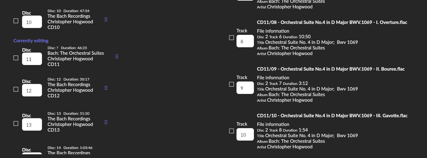

I have just unravelled a box set where discs were incorrectly allocated
This happened because the box in question contained albums as part of that box that already existed in my library
The Box is Hogwood’s Bach recordings. CD 10 & 11 are also a 2 CD set of the Orchestral Suites
When i look at the track groupings the tracks for CD11 are showing as CD1 or CD2 as appropriate, presumably because the same identical tracks exist as tracks on CD1 or CD2 of the 2 disc set.
The 2 discs are not identical as the 2 CD set includes 2 other works which are on CD6 of the main box but again were allocated to CD1 and 2
So the Grouping view for CD1 was a mix of the real CD1 and CD11 and CD6
The Brandenburg concerto discs escaped because they were CD1 & 2 in both scenarios , if not I suspect they would be scrambled too
Both albums had metadata set as per Roon’s standard for boxes , one fixed album name per album and one Album Artist per album. Sub folders are bare CD1 etc

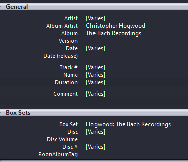

I have just tried via folders for the big 20CD box , Select all > Edit>Group Tracks
I see the album identified as Bach: Orchestral Suites which is the 2 CD and incorrect for what I selected (it should be The Bach Recordings) set also Disc 11 is identified as Disc?
This shows the Tags set for the whole box
Does this make sense, I have very few boxes in Roon for this reason I still maintain my legacy in JRiver

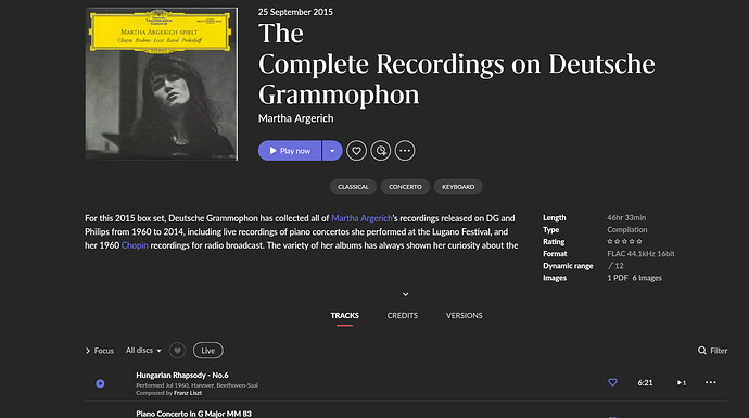

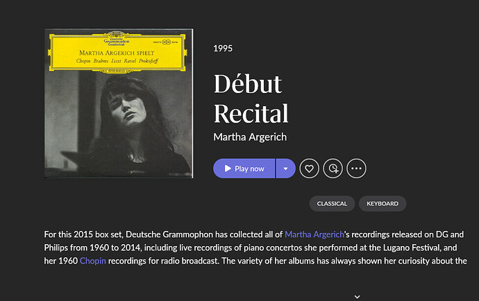

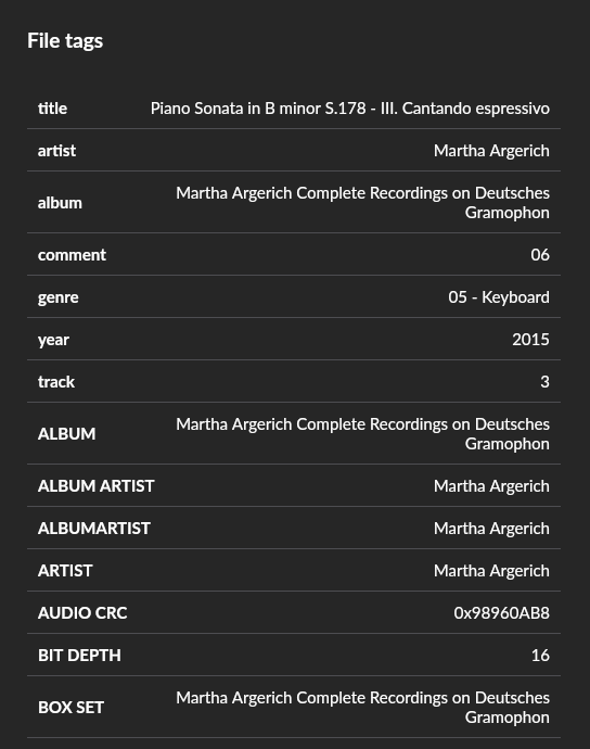

How about this one.
Single CD’s are being ID’ed as part of a Box when they are not
The Box Set of this name was removed from my library to a completely unmonitored drive
Library Clean Up has no effect

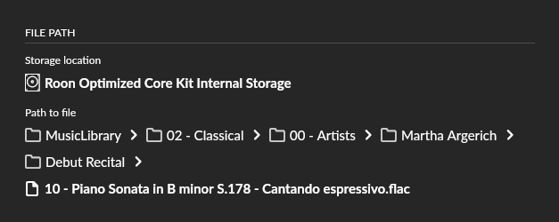

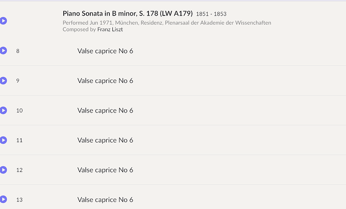

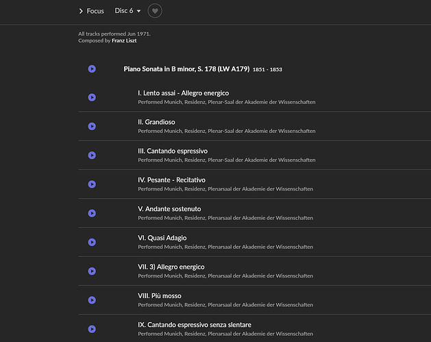

I select disc 6
file info Track 3
actual tags
Thoughts, has something changed that we don’t know about , this has been happening just recently ???

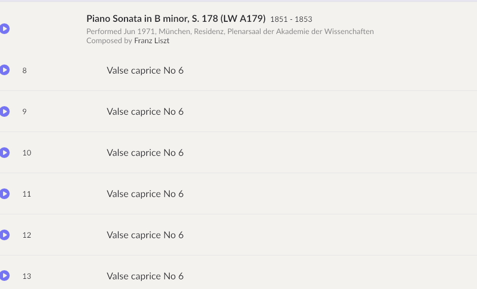

Even after forcing the tracks into the correct album, Roon still insists on showing the Complete Box text
Shame about the movements of the sonata
A couple of Select File fixes it

It’s a workaround I use often and also recommend to others my concern is that the Argerich box is no longer in a watched folder and I have done a library clean up as you suggest
BUT the box still shows with 12 discs in it after all that needless to say it won’t load, I just get the wait icon jelly fish , but shows in the discography
It’s picking up on tracks on other albums and allocating them to an imaginary box
