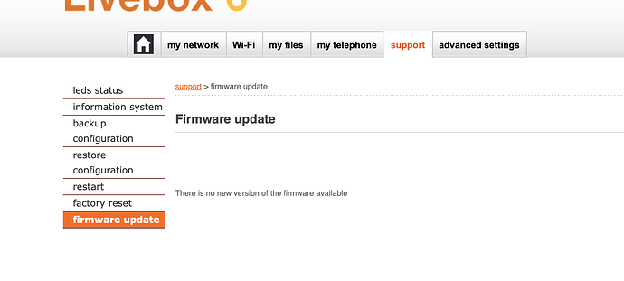

Can you do any firmware update on the router?
latest version installed
