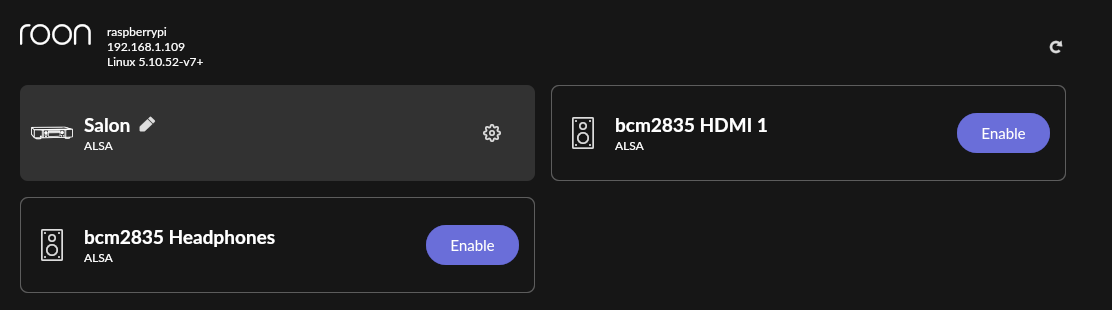

When my player is in standby mode (or switched off) then it’s not visible on the Audio devices list:
When I start my player it immediately becomes visible but in the “Device not found” state:
The same behavior is regardless of the playing mode on the device (USB-DAC, CD, network servers, …)
The only way to make it working is “Scan for devices”. Then it looks and works fine:
That’s required each time the player starts or resumes from standby.
