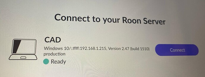

To explain what we have been through we have a couple customers in the UK that when our server is connected to a BT Hub (modem/router) they can see this on their Roon Remote app:
When they click Connect they get this screen in Roon Remote:
Its just a white screen and nothing happens - for hours…

The first screenshot does however show an ipV6 address, the last shows an ipV4.
Not that I have the slightest idea why setting up a port forwarding rule would change anything, but ipV6 has given people grief in the past…
I don’t doubt that something was probably changed on the router between the non-working and working states….
