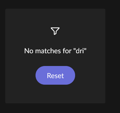

Steps to recreate:
- Select album e.g. Krasno / Moore Project: Book of Queen s
- Select Stanton Moore
- Select Discography
- Select Recordings by popularity
- Type in the string “dri” in the filter
Actual:
No matches for “dri” is displayed
Expected:
At least record Driftin’ is displayed

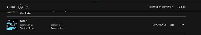

Do you see it without the filter?
without Filter the Track is visible

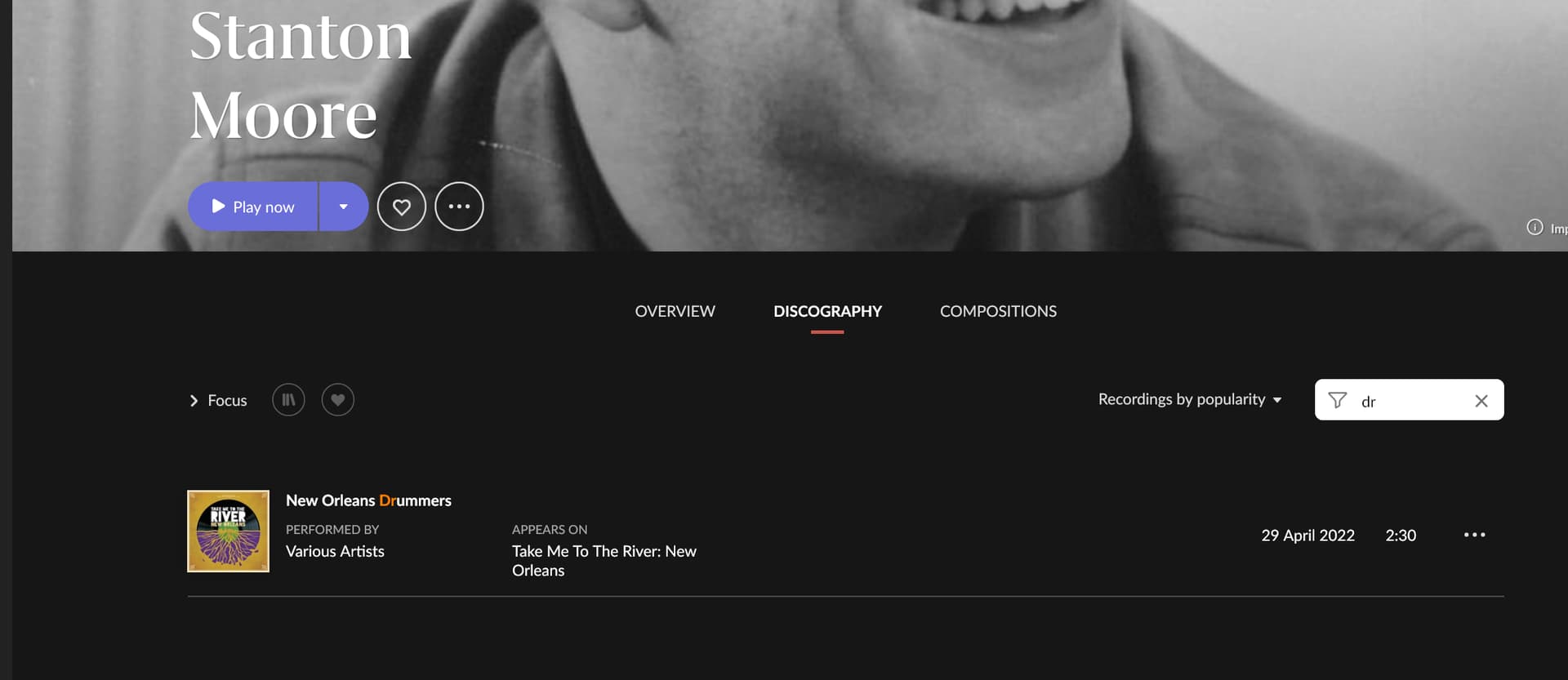

- filter works for tracks
in this example the filter works also for tracks
i set the list to Recordings by popularity
my filter is dr and the track New Orleans Drummers id displayed
- snapshot for the not working example
driftin displayed without filter

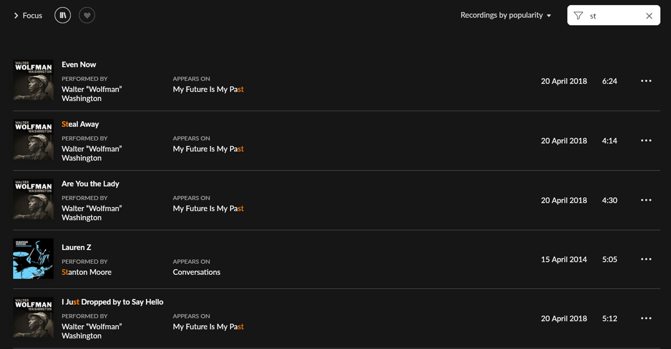

Here are my observations:
- Filter works for albums not in my library
the displayed albums are not in my library
filter string is st

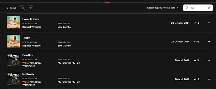

- Filter displays wrong results
filter string is wal
also entries are displayed as result, which do not contain the string wal – s. first two entries in the list

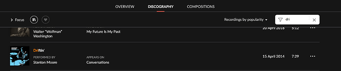

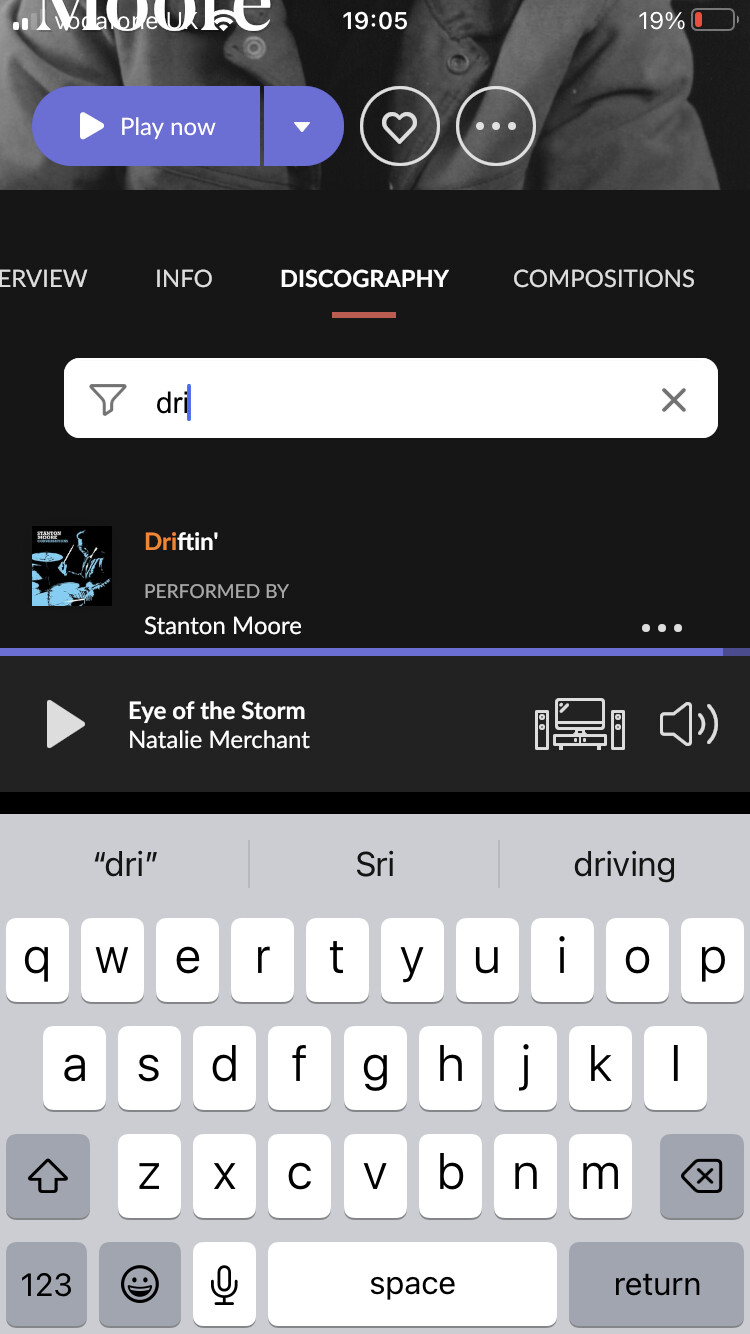

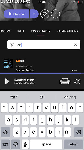

- Filter with string dri
I saw the following:
I type in the filter field the text dri
dri is selected correct in the list
the list is reloaded and the error message appears
My wish is, that the filter works correct for all members of the displayed list, independed if they are member of my library or not
the filter should filter the text displayed in the list
Most probably this due to names listed in Credits:
