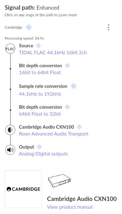

OK, so I have got back home, changed the sample rate to 192 kHz… and the problem is still happening.
The following shows screenshots of what is causing the audio file loading slowly message to come on and the track to skip within 5 seconds of starting:

When I experience the audio file loading slowly problem, a reboot of the CXN100 and/or the Roon Core seems to solve it, most of the time. So could it be that the problem is something to do with IP address allocation on the router rather than bandwidth, as such?
You are still comparing apples to oranges: The RAAT 192kHz 32 bit PCM bit stream created by the 192kHz upsampling equates to ~12.3Mbps.
The Airplay and Google Cast examples, however, have no upsampling and just send a (lossslessly) compressed version of 44.1kHz 16 bit PCM which equates to somthing significantly less than 1.41Mbps.
The the bandwidth requirement demanded of your Wifi for the RAAT examples is probably a little more than 9 times the bandwidth required for your Airplay or Chromcast examples and is thus more than 9 times as likely to suffer issues with WiFi link speed and quality.

Unfortunately, @Wade_Oram’s assessment is accurate. The WiFi bandwidth is insufficient for the uncompressed PCM stream, which is why ethernet plays back without issue.
The two options here would be to increase the WiFi bandwidth or to switch to a hardwired connection. Alternatively, you can lower the sample rate in Device Setup.
