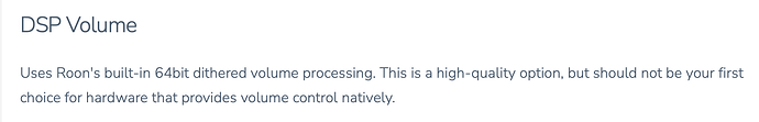

Roon’s current documentation does not mention any restrictions, though. That is why I was under the impression that DSP Volume always was an option.
