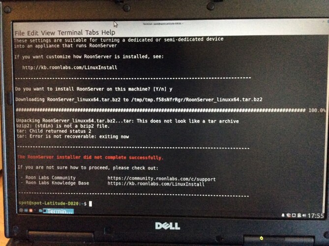

Roon stopped working so I ran all updates for Linux and tried to re-install roonserver. I followed the “installing Roon on Linux” page from the website.
I keep getting the error “ this does not look like a tar archive”
see screenshot…
I would inspect the file . Go to the folder /tmp/tmp.f58sNfrRgr: Is the file size around 109 mb? if not, then it’s probably not what is expected. Inspect the file with a text editor. Does it look like a HTML file? If so, please post it’s content here as it might help debug your issue.
I don’t know Linux Mint, but to me it looks like you are running a graphical desktop. So a graphical file explorer should be available to use. Maybe others can chime in with more detailed instructions if you can’t figure out yourself how to do stuff.
I found a download named roonserver_linuxx64.tar.bz2
It is listed as 84.3mb
When I try to open it I get a jumble with a lot of words in red; was taking forever to load
That seems to be to big for a HTML file, but is also to small for the actual file expected. Probably a network issue (download interrupted before finished)? As I had no issue at all, downloading the file, you might just want to try again. If that doesn’t help, then I don’t know. I personally would open the installer file and start running the commands therein manually to see if I can get more information about what’s going on. Also system logs might contain valuable information.
This is not the best premise for troubleshooting on your end, you may have to do a lot of reading. I’m the wrong person to teach you Linux administration and troubleshooting. Maybe another user is willing to try and help here?
the download interruption issue is a real possibility; i am having an issue w my internet right now where the download speed fluctuates wildly from over 900 (what i am paying for) to very slow; could have been the problem.
comcast is coming tomorrow to fix; assuming they do, i will try this all again.
agree i am at a disadvantage with limited linux knowledge; the roon over linux experience has been easy and bulletproof until this hitch.

Run these commands from the terminal. Press ctrl+alt+T
many thanks; alas, i had the same result: did not install sucessfully; "this does not look like a tar archive”
my internet issue has not been solved, though i mostly get very high download speeds; i have a new router coming on monday so will install that and try this again
mjw
10
Did you follow my instructions precisely? You aren’t downloading a TAR archive: it’s the easy installer script.
well bummer
i deleted all the old downloads (none were left); followed your instructions again and got same error message again
[had to install midnight commander and figure out how to use it…]
For sure you can try that, but for now it looks like you’re unable to (reliably) download data from the internet (network issue), so I’m unsure another distribution will correct that. If you have another machine available (Windows, Mac OS), you can try and download the archive there. If that works reliably, then your issue is related to the Linux machine and if not, then your ISP (in general or the modem issue you already pointed out) is to blame.
Here is the download link for reference: https://download.roonlabs.net/builds/RoonServer_linuxx64.tar.bz2
