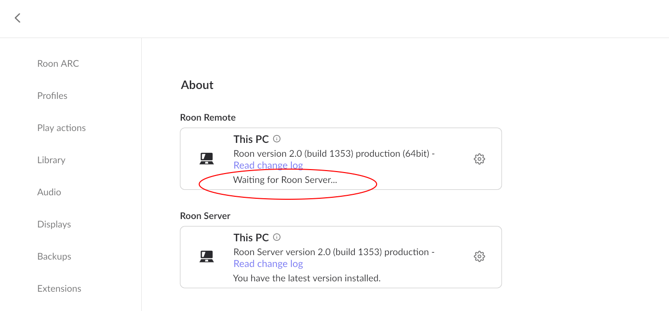

Since build 1353 I cannot backup. I get this message:
Roon server status is that it is running but the roon back-up service thinks it is not. The system is hung and I need to re-boot. I tried that several times with the same result and then tried re-installing roon. Same result.
Everything else seems to be working but I cannot backup.
If I look at the status in “About” I see the roon remote is waiting for the Roon Server and yet I am playing music on two end/points right now:
Am I doing something wrong or have I not understood the recent architectural changes in the last release?

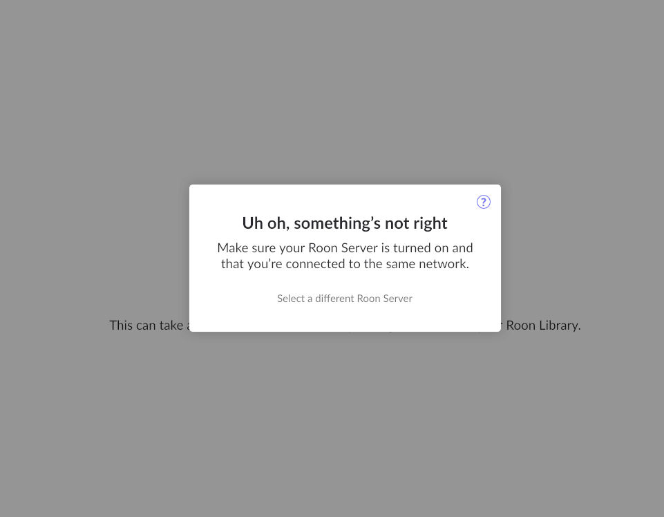

@Ivan, I already posted the error message I get when I attempt a backup. See above. I get “Uh, oh, something’s not right”. Roon then hangs, becomes unresponsive and I have to re-boot. For the moment I have given up any further backup attempts.
This error message is just as uninformative to me as it is to you. Perhaps if roon issued a more boring but traditional error code, that would be more helpful to all parties with the diagnosis?

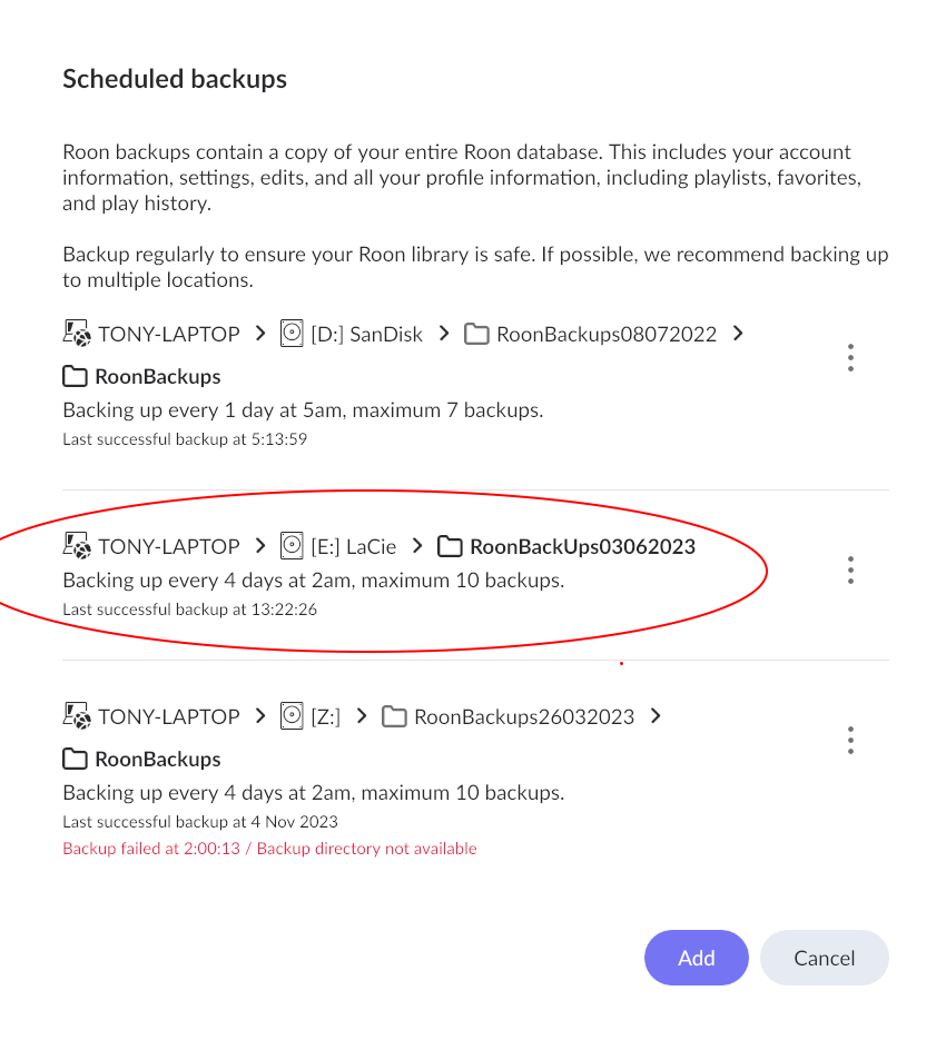

I am getting a little confused. I have multiple scheduled backups and the one at 5am this morning to my D: drive appears to have been successful. Is there any easy way to verify that?
I then tried to do a forced backup to a different location to my E: drive
And that worked as well.
