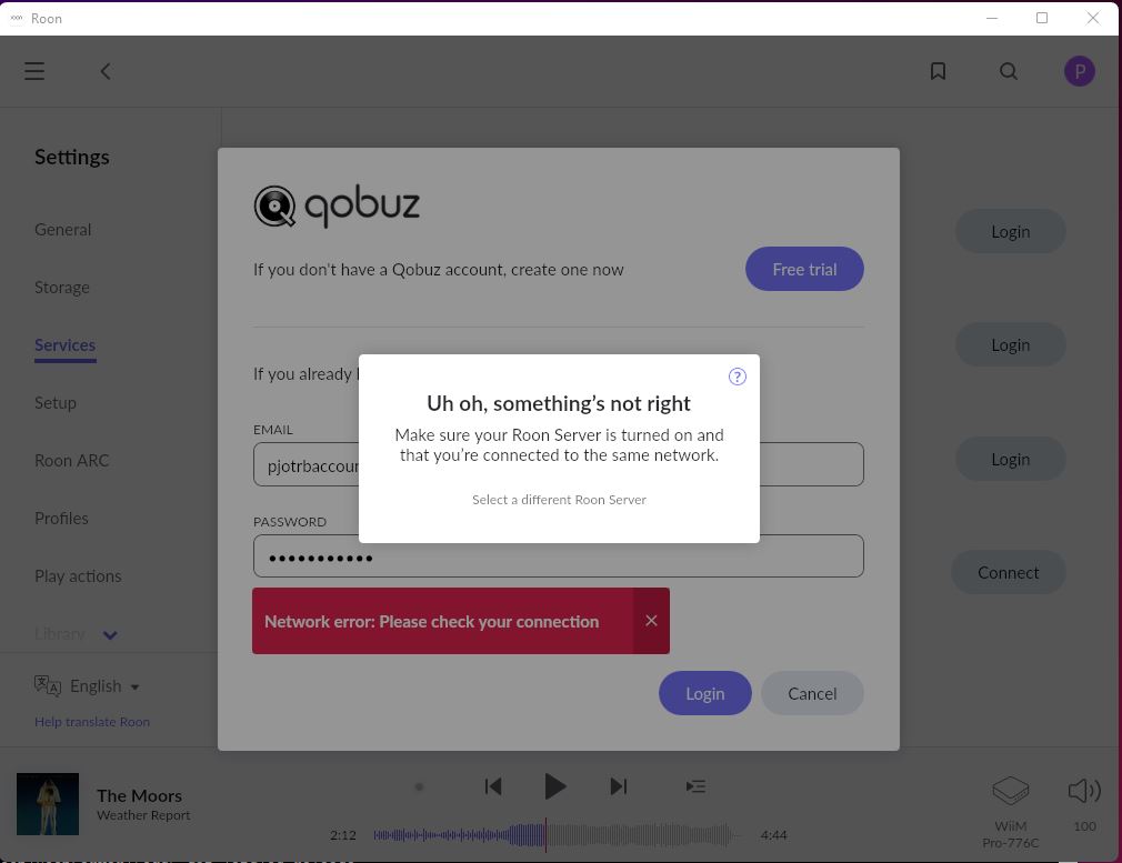

I cannot connect Qobuz to Roon anymore. Network error when trying to sign in to qobuz. Seems to have happened when changing KPN (ZTE) router to the new Fritzbox router (not changing the network ip's).
· I read about many same issues in previous years. No clear solution found as far as i can see.
A suggested solution (replacing bits-file with new one) was done by me, did not help. Also removing the Roonserver Cache folder dit not help.
Please provide a new solution.
In Roonserver I cannot connect to Qobuz: When trying to sign in I get a network error: Please check your connection (see screenshot)
- I have restarted router, nuc, devices multiple times
- I have reinstalled all remote Roons (desktop, tablet, phone)
- I have reinstalled Roonserver on the NUC.
- I have installed a new file called "bits" as was suggested in older support thread.
- First real qobuz related error in logfile: Warn: {easyhttp} [80] GET https://www.qobux.com/api.json/0.2/user/login?device_... mail=...&password=....: socketerr (HostUnreachable): No route to host (34.242.7.204:443)
Hardware: NUC5i5RHYH (5th gen i5 processor)
Software: Roonserver (nuc/linux) 2.0 build 1413
Software: Ubuntu 20.04.5 LTS (Focal Fossa)
NUC is connected to my network with Netgear switch.
Router is a new Fritzbox 7590AX
Seems like the error appeared not long after I switched to this new router.

  1. Cannot connect to Qobuz : network error
  2. Search function does not work anymore : Can’t connect to Roon Search
  3. Most (not all) album art covers disappeared (grey square). When choosing an album I can see a quick flash of the cover, then it just shows grey.
Waiting for a solution,
KR,
Pjotr Bee
