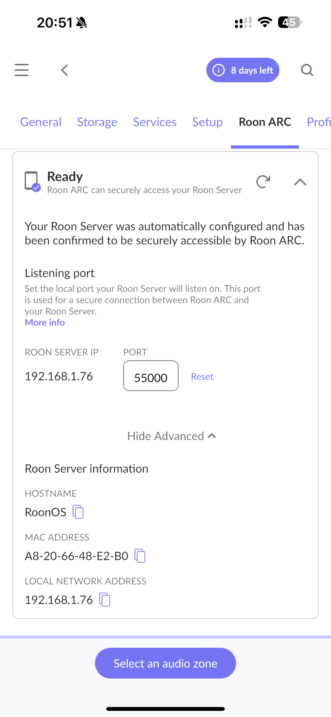

Room works perfectly at home. Going into settings > Roon ARC in the Roon remote app, the system says the server is reachable and configured correctly - however, the arc app doesn’t find the server.

Screenshot

55000 is the port specified in the Roon app on the Arc page (as in the screenshot I posted initially).
