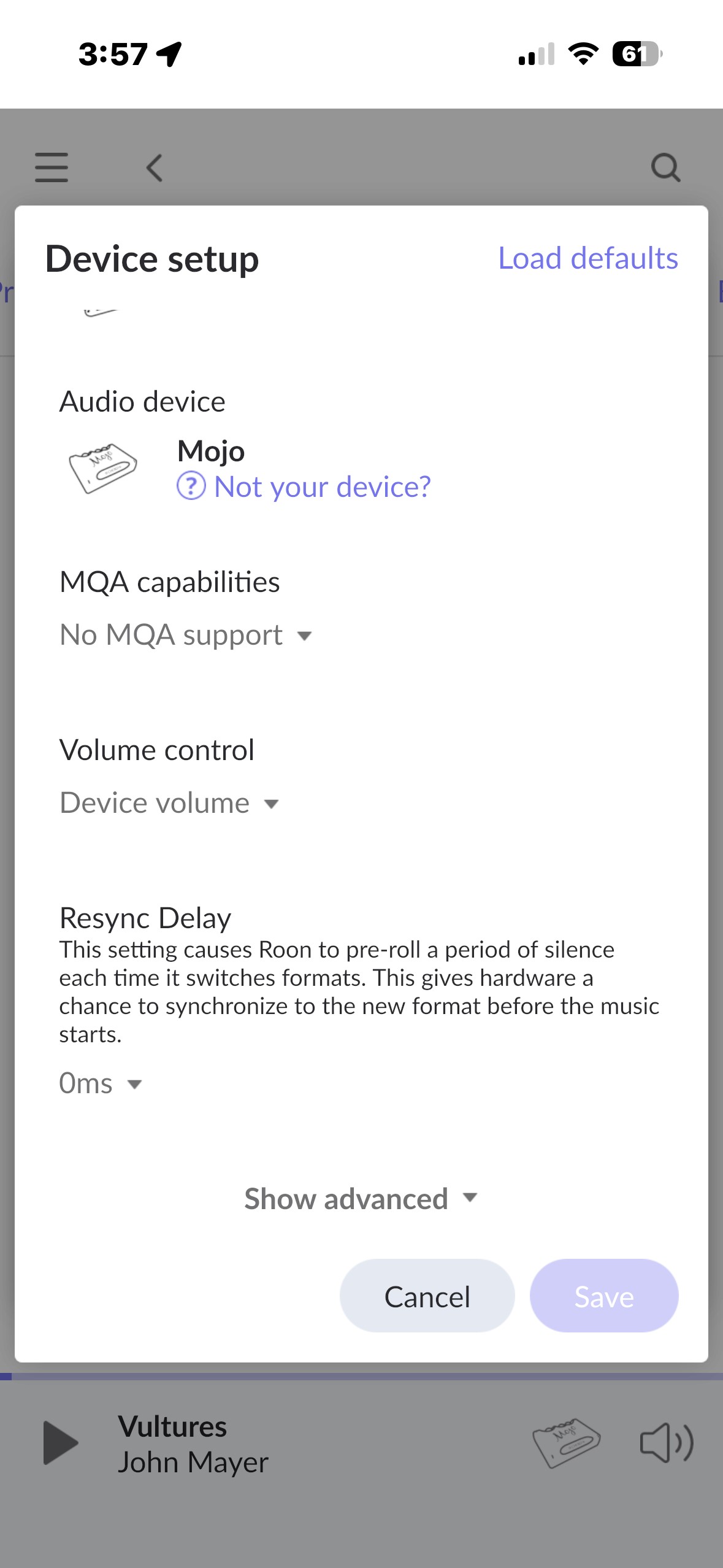

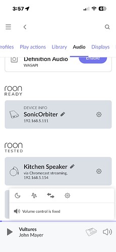

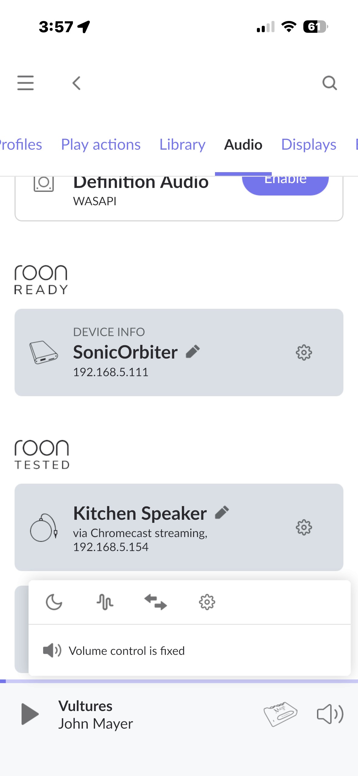

I am unable to control volume remotely. Even though I have selected ‘Device Volume’ on Audio Setup (see screen shot) the system shows ‘Volume Control Fixed’ when I try to adjust volume from my iphone App.
I used to be able to control volume from the App.
Any suggestions appreciated.
Thank you.

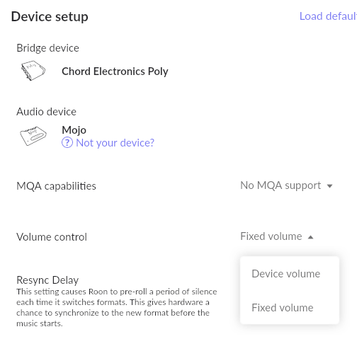

Networked endpoints, i.e., Roon Bridge, do provide DSP volume control whether USB or S/PDIF. Likewise, so does the Poly. However, I can’t comment on the MicroRendu.
Never seen that on my system.
grafik
No “DSP Volume” available.
Networked endpoints (primitive networked audio devices {Roon Ready}) don’t. Roon does for locally connected devices (Roon Server, Roon, Roon Bridge they all do – maybe even the mobile variants Roon Remote? Not tested).

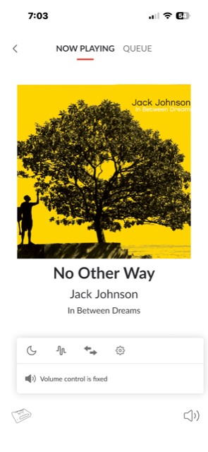

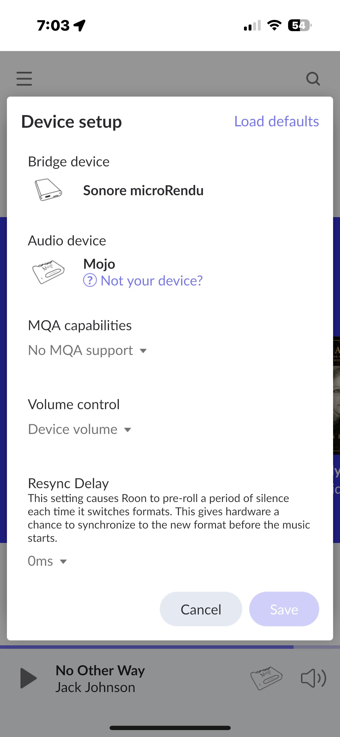

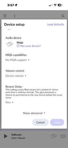

I cannot see a DSP setting? You’ll see from the attached jpegs that the Audio Setting for the Mojo is Device Volume yet when you click on the playback it shows Volume Control as ‘fixed’?
I reset the MicroRendu back to the last 2.8 version and the Device Volume control functionality returned. It is clearly a Sonore issue with their latest 2.9 release and I have advised them. Thanks to all who tried to help me. Much appreciated.
Update. The fix is simple. Volume control via MicroRendu and Mojo can be controlled by Software via MR tab at SonicOrbiter.com and Roon Ready icon. Simple fix in the end and shows that you can control volume when using Mojo DAC. Thanks for all help.
