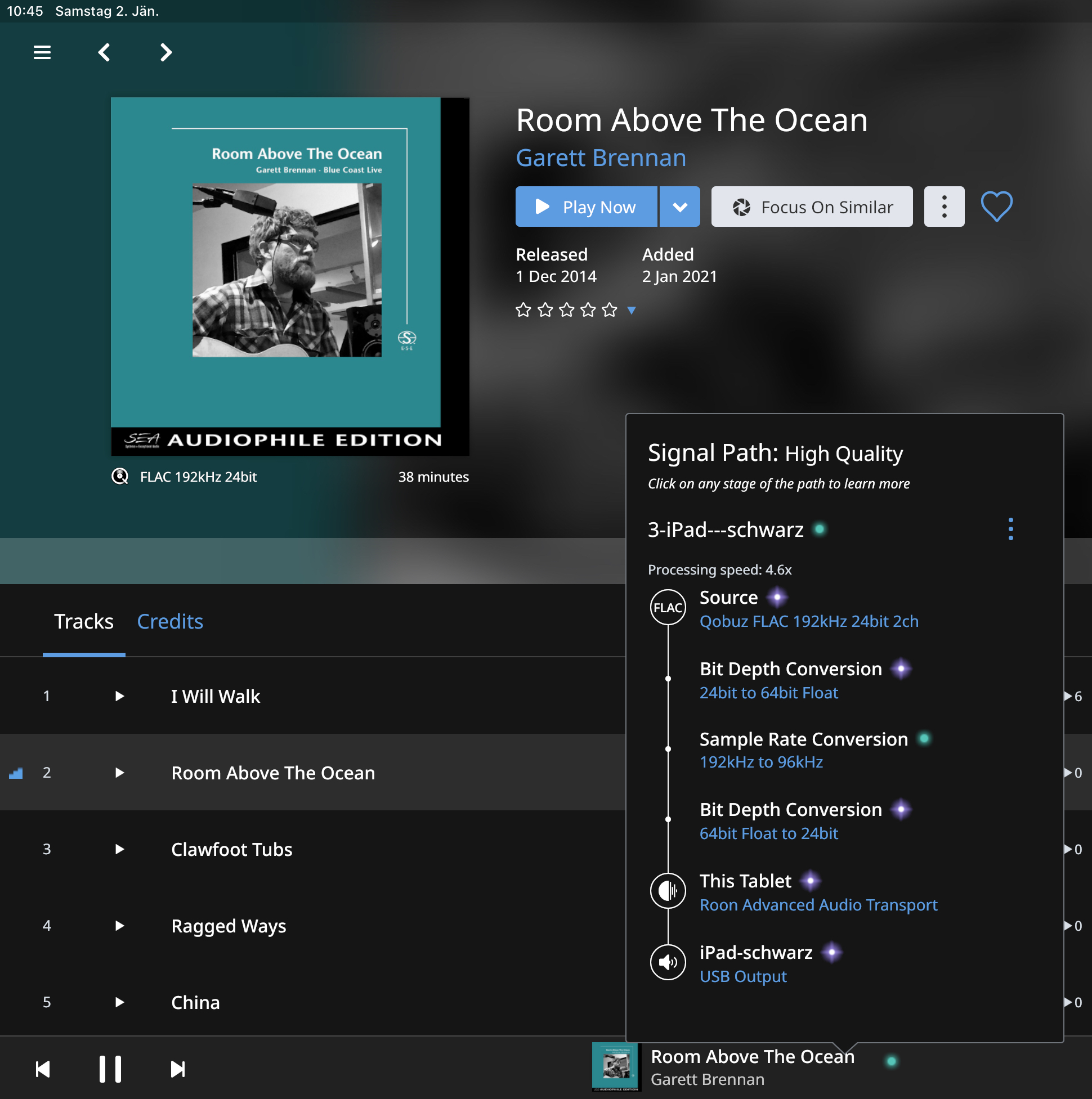

playing Qobuz 192/24 to iPad Pro and lightning-adapter to Dragonfly RED
I cannot get 192/24
Do i have a false setting? - I cannot find the error

I would imagine it’s because the Dragonfly doesn’t support 24/192.
You are right - i am a fool - sorry
I read so much of 192/24 with dragonfly that i really thought it can play 192/24.

It can “only” 96/24

I now plugged in an E1DA 9038D
And it is working fine with 192/24
