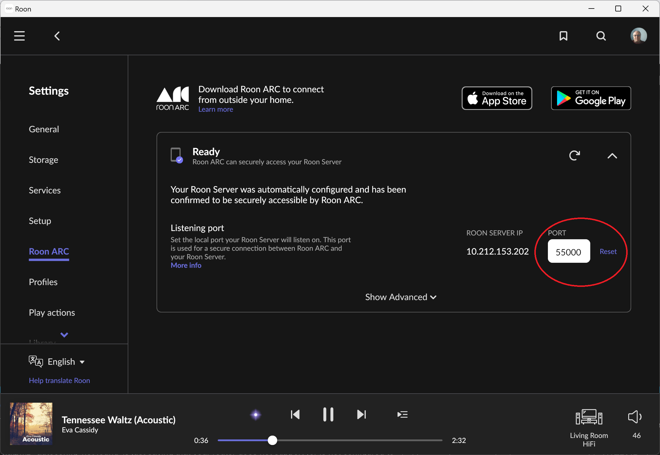

You should try using a different port for ARC. In Roon → Settings ARC set a different port number (typically in the range 1024 - 65535).
The default is 55000, so trying 60000 might be a good start.

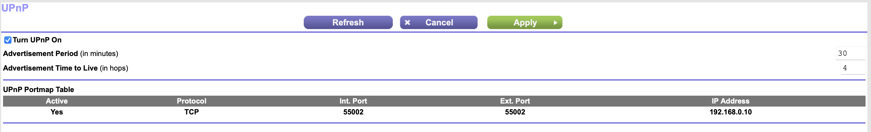

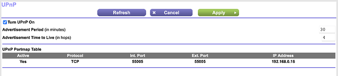

I had a look at my router and for UPnP it says the following:
192.168.0.16 is not a currently attached device. I guess when I manage to delete this line, things might get better. - But how can i delete this entry on the router (a Netgear D6200)?

I’m guessing that that rule is left over from a previous uPnP configuration request. Has the ip address of your Synology diskstation changed recently? Such things can occaisionally happen when ip address allocation is left to DHCP.
The ARC error diagnostic that you posted mentions ‘ConflictInMappingEntry’. This is the cause of the issue. It is saying that it cannot honour the uPnP request to forward traffic because traffic for the specified port is already being forwarded to a different ip address. I’m assuming your Roon Server is configured to use port 55005 for ARC connectivity (in the Roon->Settings->ARC settings page as in the image I posted above). This would explain the conflict with the rule shown in your router screen shot.
I would start by rebooting your router - then wait for it to stabilise. Hopefully, this will clear out the previous port forwarding rules created by uPnP. The uPnP Portmap Table should, at this time, either be empty or it should show a new forwarding rule for the Roon Server with the correct ip address.
If Roon is still reporting a conflict in mapping entry, then restart your Roon Server. I believe that you can do this by stopping and then restarting the Roon Server service on the Synology - you should not have to do a full Synology reboot (although that would achieve the same result).
If you still have the same problem, and the 192.168.0.16 port 55005 forwarding rule has not gone away, then the easiest solution would be to change the port in Roon to avoid using 55005. Try using something like 60000.

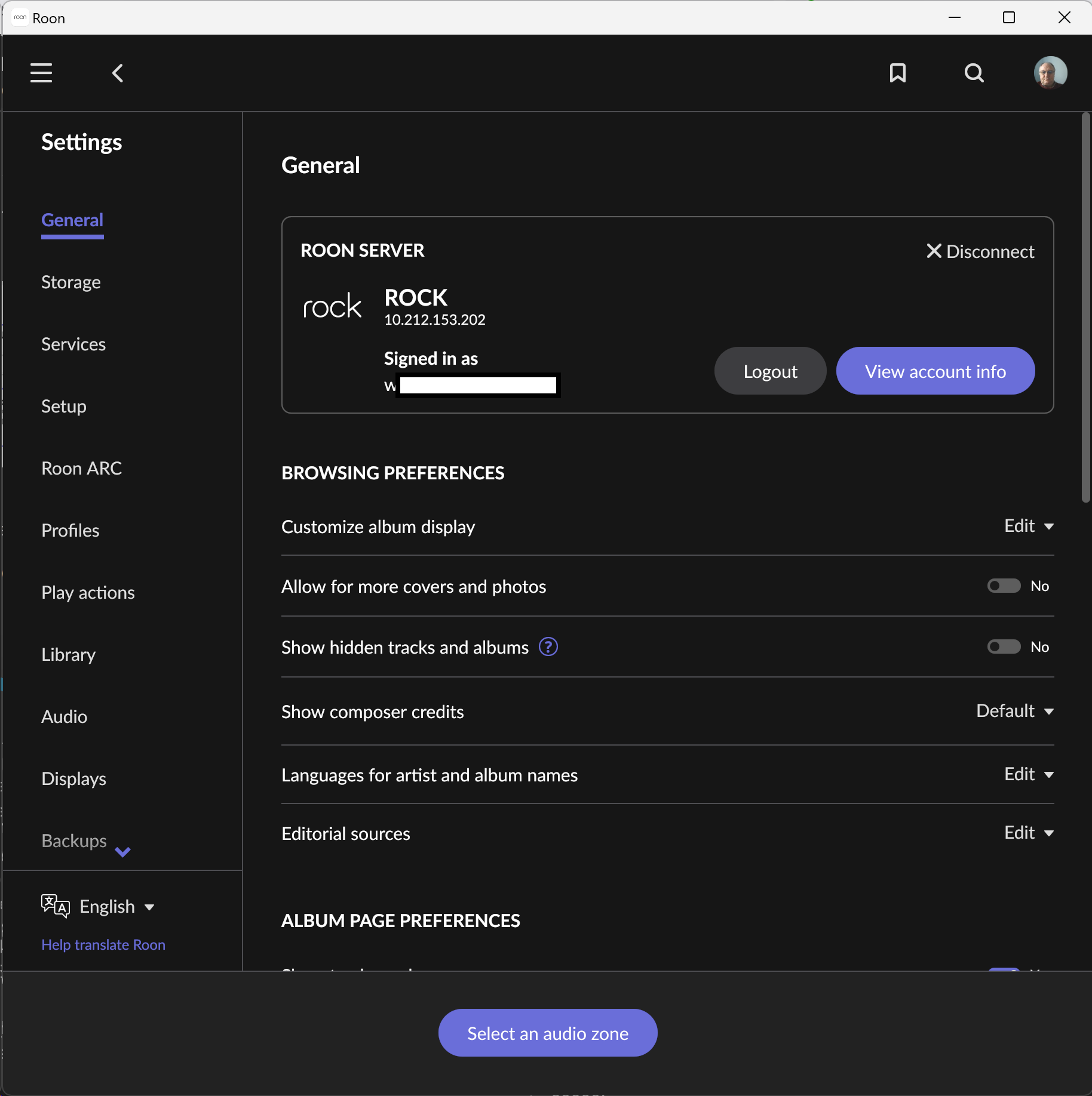

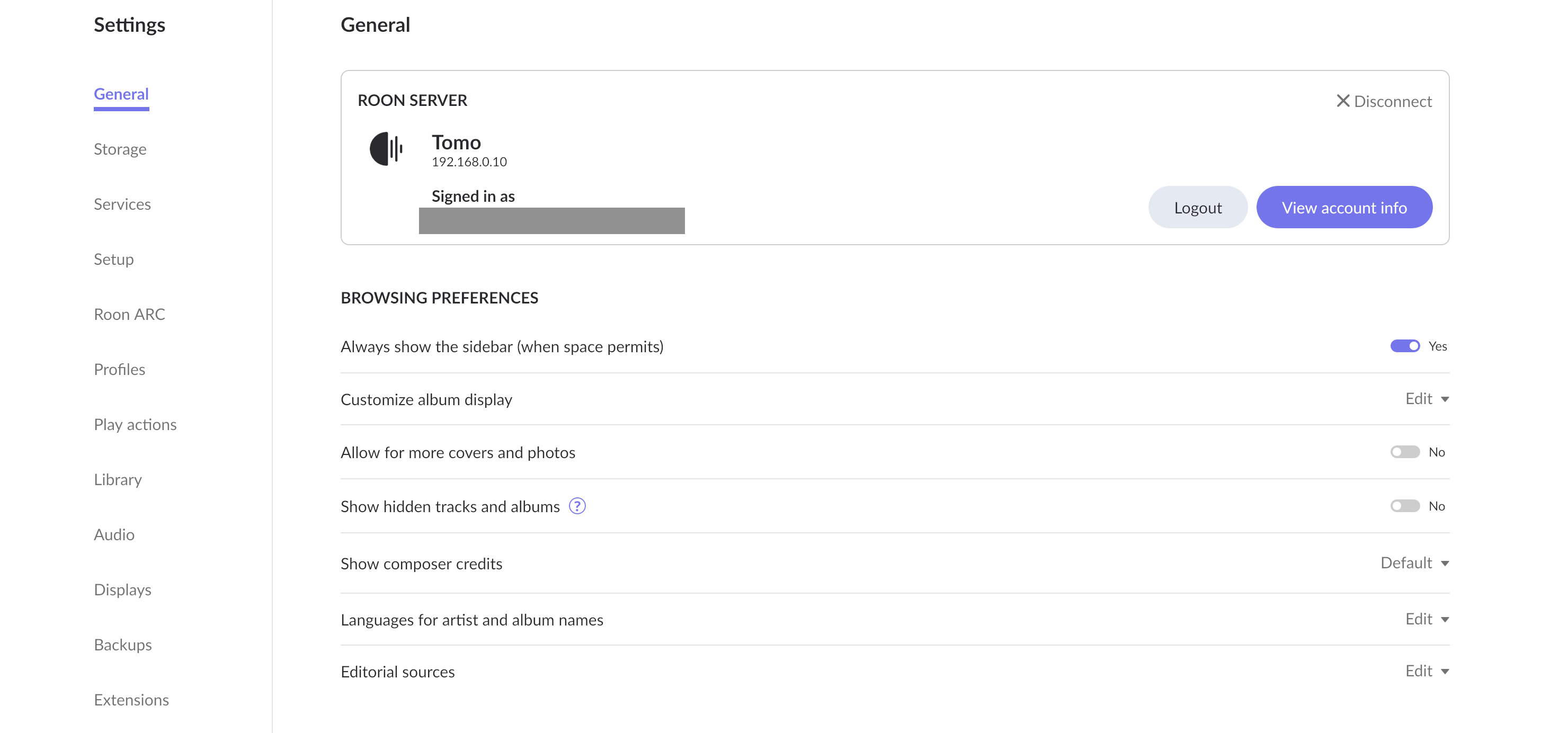

As a matter of interest, could you post a screen shot of your Roon->Settings->General page showing the details like (Note: you should block out your email address as I have done before posting):

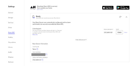

Ok, firstly I managed to get the server configured for Roon ARC:
The trick was to fix the IP address of the Synology (the Roon Server) in my router and to reboot evrtything. :smile: Thanks heaps for your help!
Secondly, here the info from the General pane:

I can also see that you changed the ARC port from 55005 to 55002. This alone should have fixed the issue because it means that the port (55002) now being requested to be opened and forwarded to the Roon server does not conflict with the old rule (forwarding port 55005).
However, the router reboot should have cleared out the old rule anyway. What does your router’s uPnP portmap table (as posted in your post at Cannot get Roon ARC working - #7 by hallo_leo) look like now?
It should have just one entry forwarding port 55002 to the Synology hosted Roon Server at 192.168.0.10.
Yes, it does show exactly and only this:
