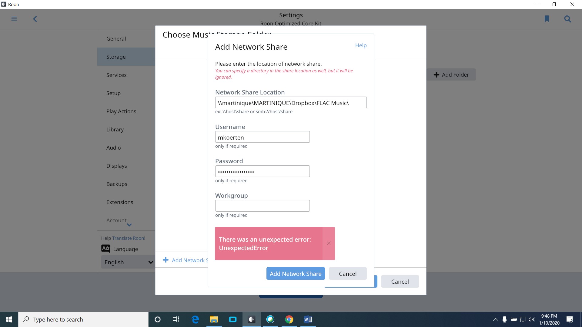

I am trying to remap my Synology DS418play NAS to Roon after switching my internet service. After the IP address switched on my DS418Play Roon no longer could connect.
I was able to successfully map the Synology network drive to my Lenovo Laptop. Here’s a screenshot my local directory I used to map to and how I am trying to type it into the network share in Roon:
Since its a PC I am using the Windows explorer file format (ie. \Martinique) as my way of connecting it to Roon.

try using the new IP instead of the host name.
Hi !
Here my syno is named diskoboule, and the good path was \diskoboule.local\Music, so i would try \martinique.local\MARTINIQUE… for your network/nas.
Thanks for the help guys!! I got it mapped using the IP address. All set. I forgot that my Roon Rock core is running Linux. So I had to use SMB to map my Synology.
smb://192.168.1.204/Martinique
I set the IP address on my Synology as static in my separate reserve pool outside of my DHCP addresses and it works perfectly. Once I had it mapped I was able to select the directory folder where my music files reside. The mistake I made was trying to map the entire folder directory. I thought authenticating via the Synology admin vs a regular account might have been causing the issue but, it was trying to map the entire directory that created the error.
