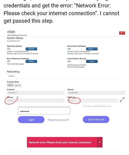

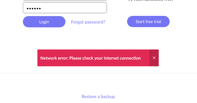

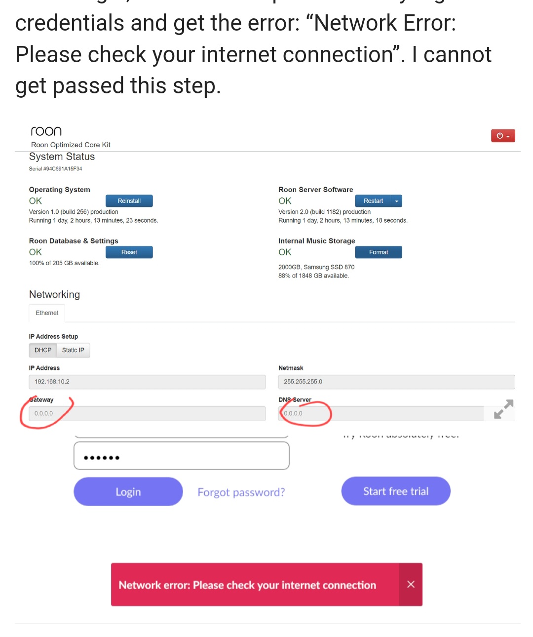

I open the roon app on my laptop and click connect to the roon computer. At that point it asks me to login, where I attempt to enter my login credentials and get the error: “Network Error: Please check your internet connection”. I cannot get passed this step.

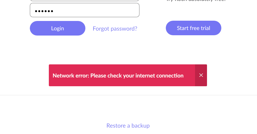

When I try it on the ipad with a new Roon app installed, I get exactly the same error when I try to login to the roon app with my credentials. Even if I click forgot password, it gives me the error message that I am not connected to the network.
For your information, both are connected with an ethernet cable to the same switch that the roon nucleus is connected to. I have no problem seeing the nucleus on the ipad or the laptop, but the problem is with the “log in” step. I know the login information is correct, because I can easily login on the roonlabs.com website on the browser on either device.

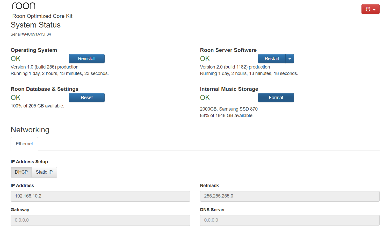

Something’s definitely wrong here.
This is what your web UI looks like:

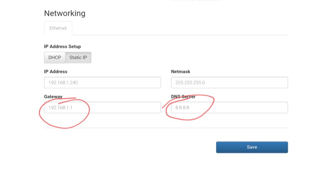

And like this for me:
As you can see, your Gateway and DNS Server fields are filled with 0.0.0.0
It shouldn’t be like that. 0.0.0.0 is not a valid destination address, but simply an invalid configuration.

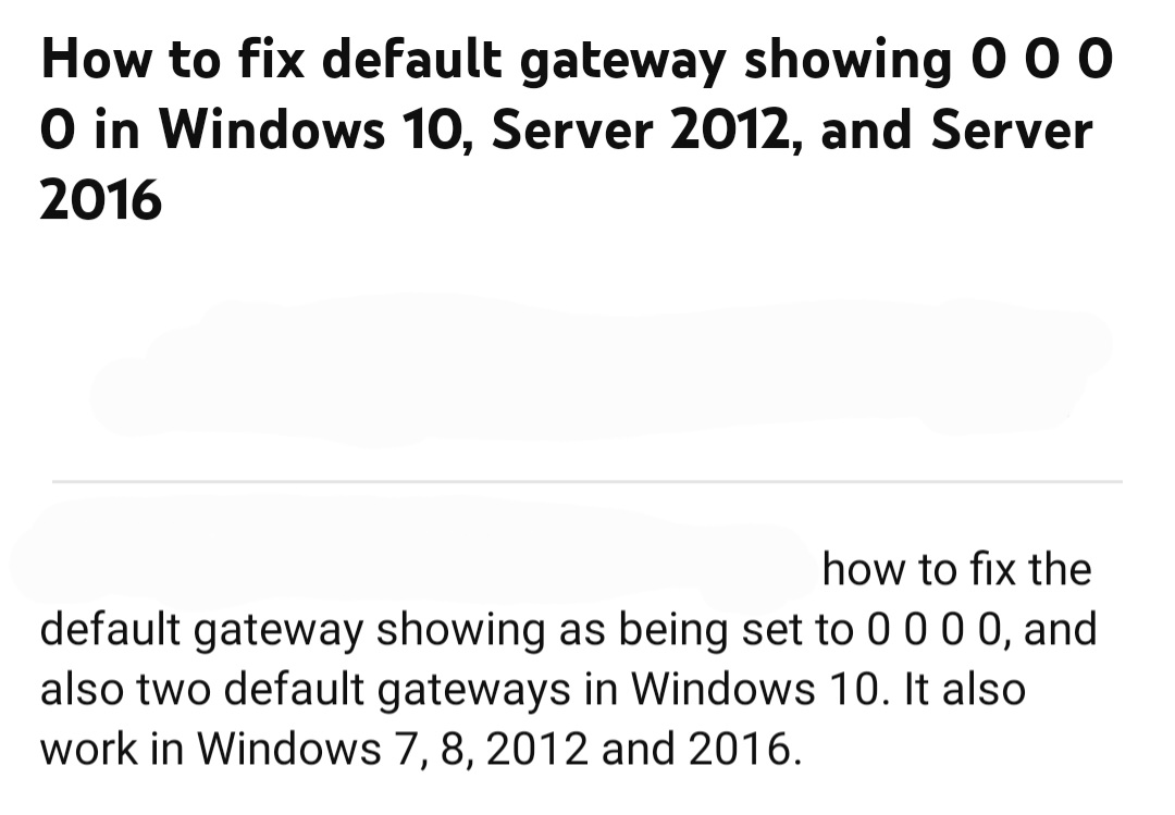

A quick search for gateway 0.0.0.0 error came up with:
https://social.technet.microsoft.com/Forums/windows/en-US/765aa1c6-dd9a-4447-9de0-aecc41498b04/windows-7-two-default-gateway-0000?forum=w7itpronetworking
For Win 10
Axel,
You hit it right on the nail. I tried to get connected to by manually entering the static IP information and I was able to do it. I will work on getting the DHCP side fixed tomorrow by following the instruction in your link. Your help is greatly appreciated.
