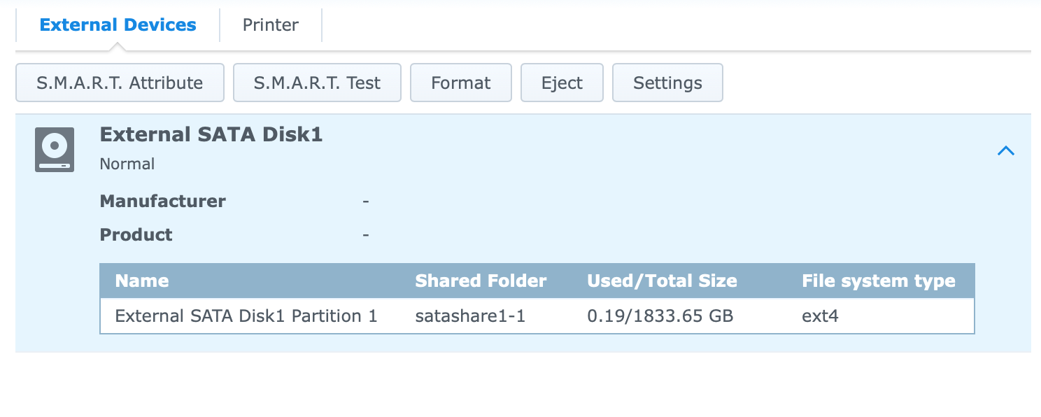

    This is how my drive is listed in the “External Devices” section of the DSM:
Have you tried to format the esatadrive on the diskstation? (!! Be aware, this will erase all data on the drive !!)
