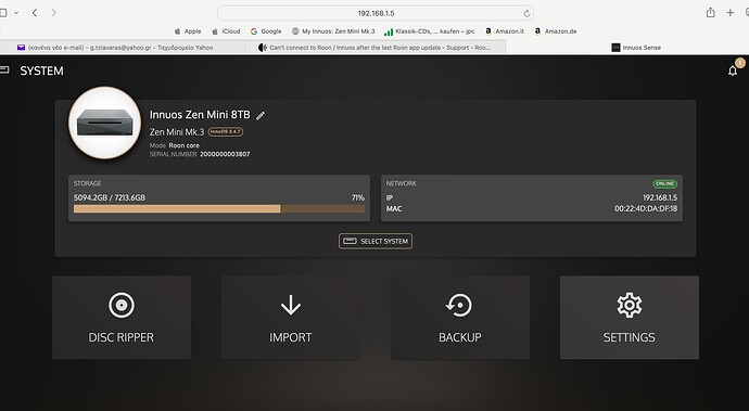

innuos is connected with ethernet

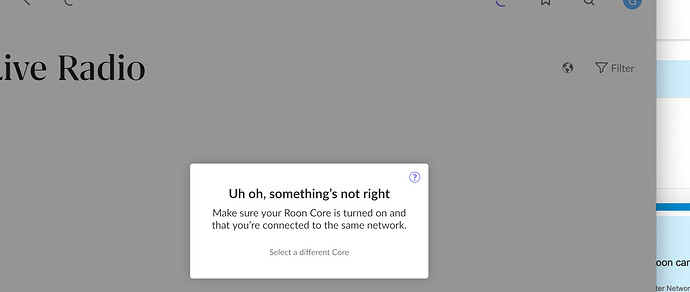

I’m trying to open Roon app after the last update and it doesn’t work

innuos is updated

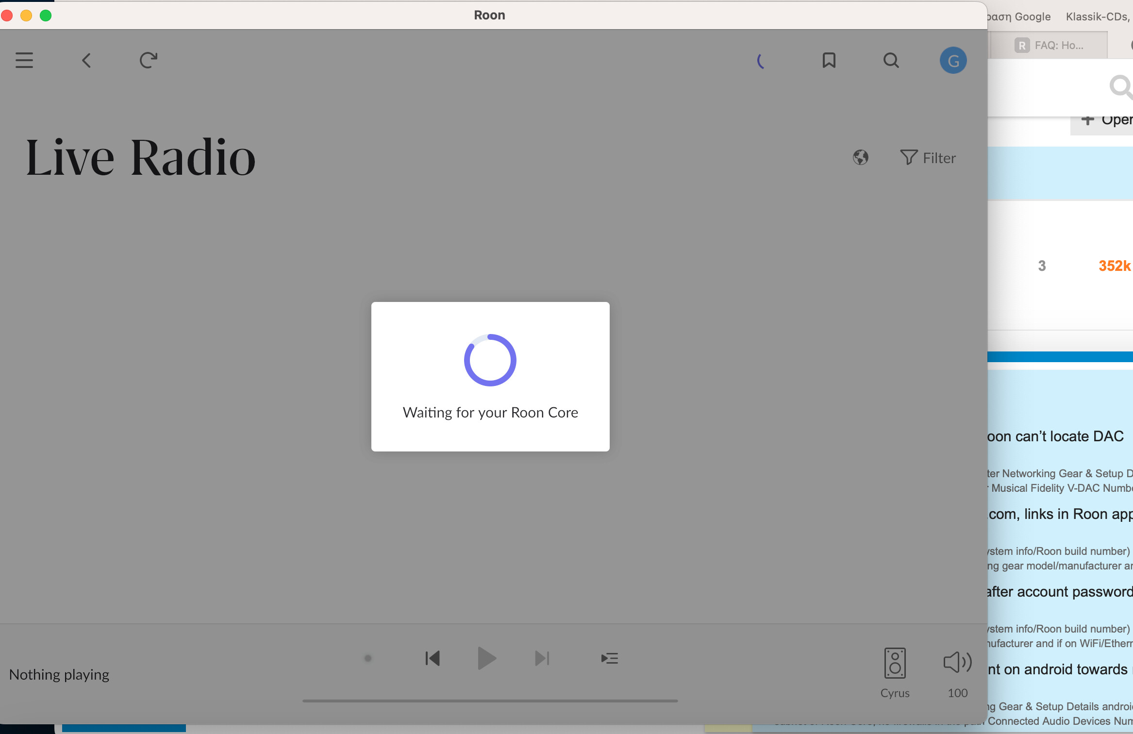

thank you for your response. I didn’t find any help or solution to my problem.
the app still won’t connect to my pc.

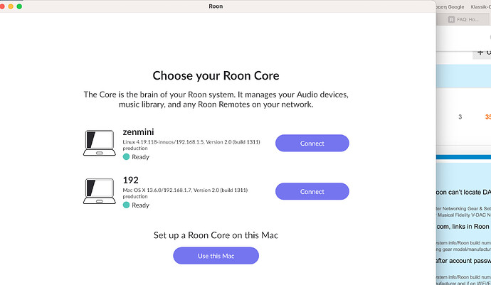

An attempt is made and then after a while it shows a message “unable to connect to Roon” “select another coret”

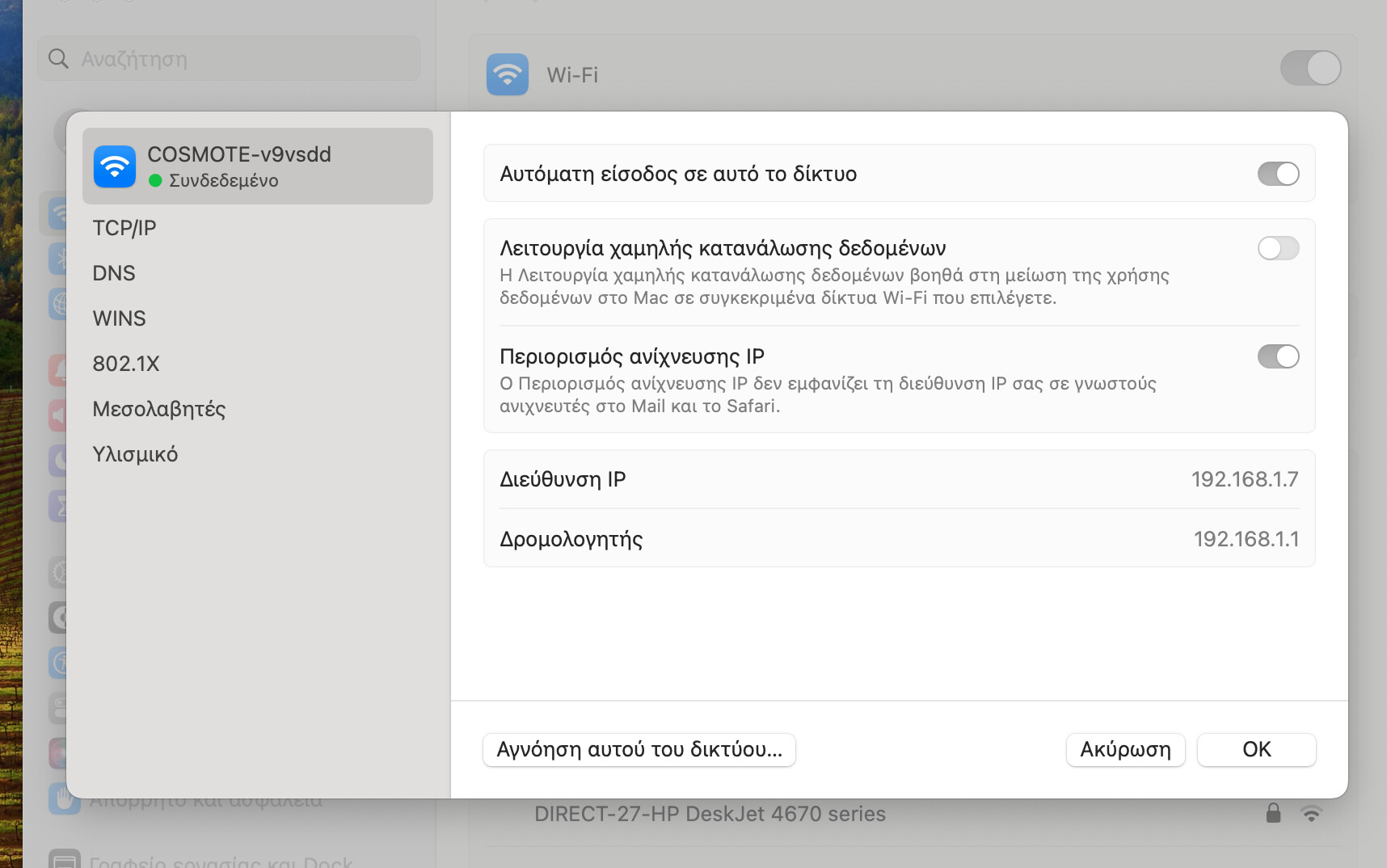

With that, I also noticed from your account page that you may be running two different subnets within your local network. Roon is only able to function when all devices are on the same subnet, so a good next step would be to review your router settings and ensure that:
  1. Your second subnet is disabled (if you aren’t using it with other devices.)
  2. Your Innous and Mac remote are both on the same subnet.
Let me know what the above looks like, I’m confident we can get things up and running smoothly for you ASAP. :pray:
Thank you very much for your answers. But my system worked pretty well for about 4 years. The problem started when I last updated the app Roon. Stopped connecting. The innuos is connected to my router with an ethernet cable and the mac book air gets a signal from the router’s wireless network. I think mac book air has very satisfactory memory and processor. I hope I helped somewhat
Both innuos and my laptop are in the same subnet
laptop 192.168.1.7/24
innuos 192.168.1.5/25\24

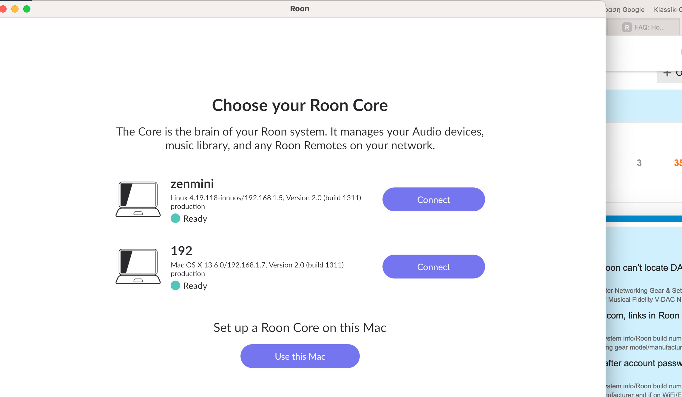

From a screen shot above, two Roon Cores are listed
  • Zen
  • Mac
To avoid confusion, can you confirm which is been used as the Roon Core.
