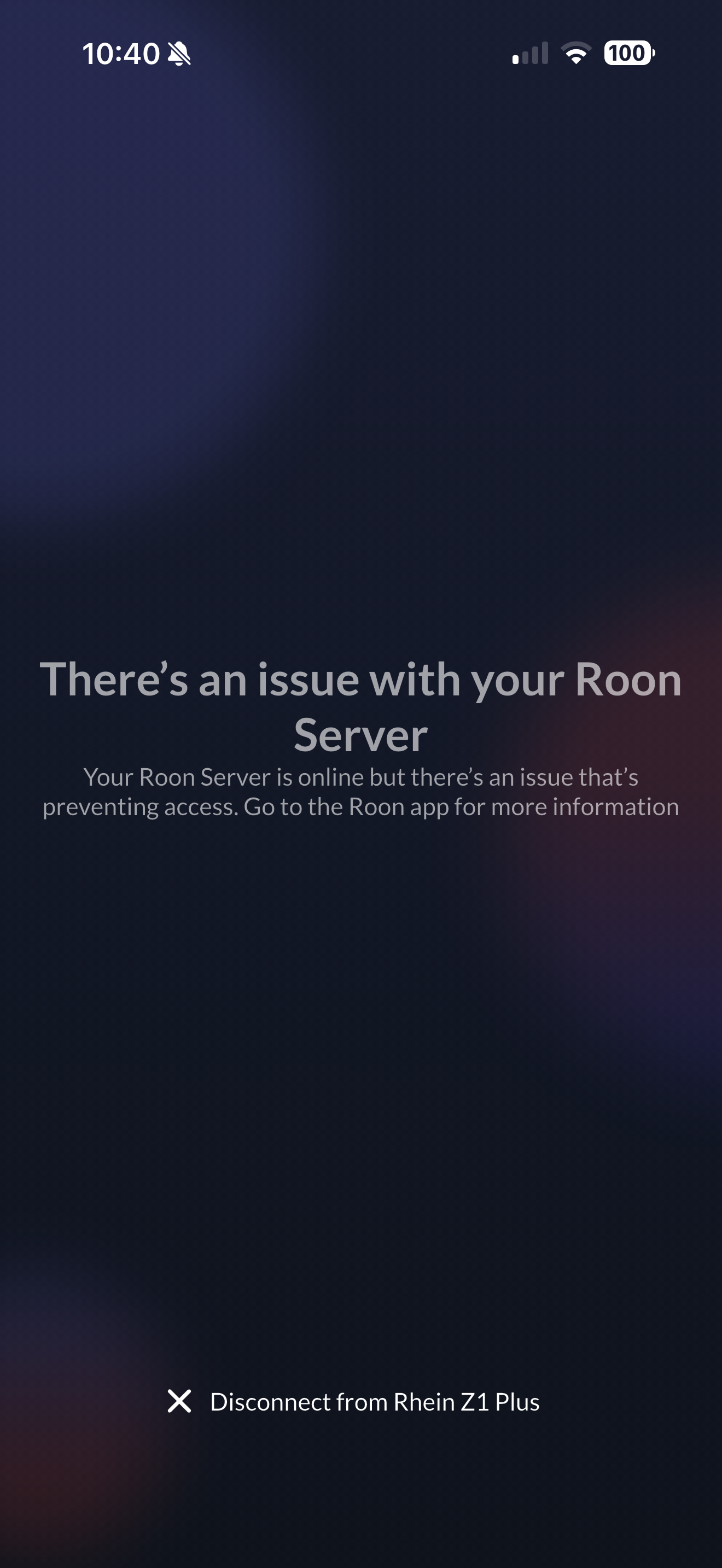

Can't set Roon ARC to "offline mode" when server is down.
We are having intermittent server issues. If I'm already in Offline Mode, ARC still works. However, when the server is down I can't turn on Offline Mode from the startup screen to get to the hundreds of albums on my phone.

I also noticed you’re running a silent angel Z1 as a Server machine, and therefore very likely experincing a known silent angel issue that has popped up with one of the recent Roon updates. Read more here:
You may be best off getting in touch with silent angel directly in this case.

Silent Angel is up and running. It’s delightfully quick.
However, I needed ti uninstall and reinstall ARC to free the space used by downloaded albums. I’n guessing it would be harder to preserve Downloads when disconnecting/connecting servers.
