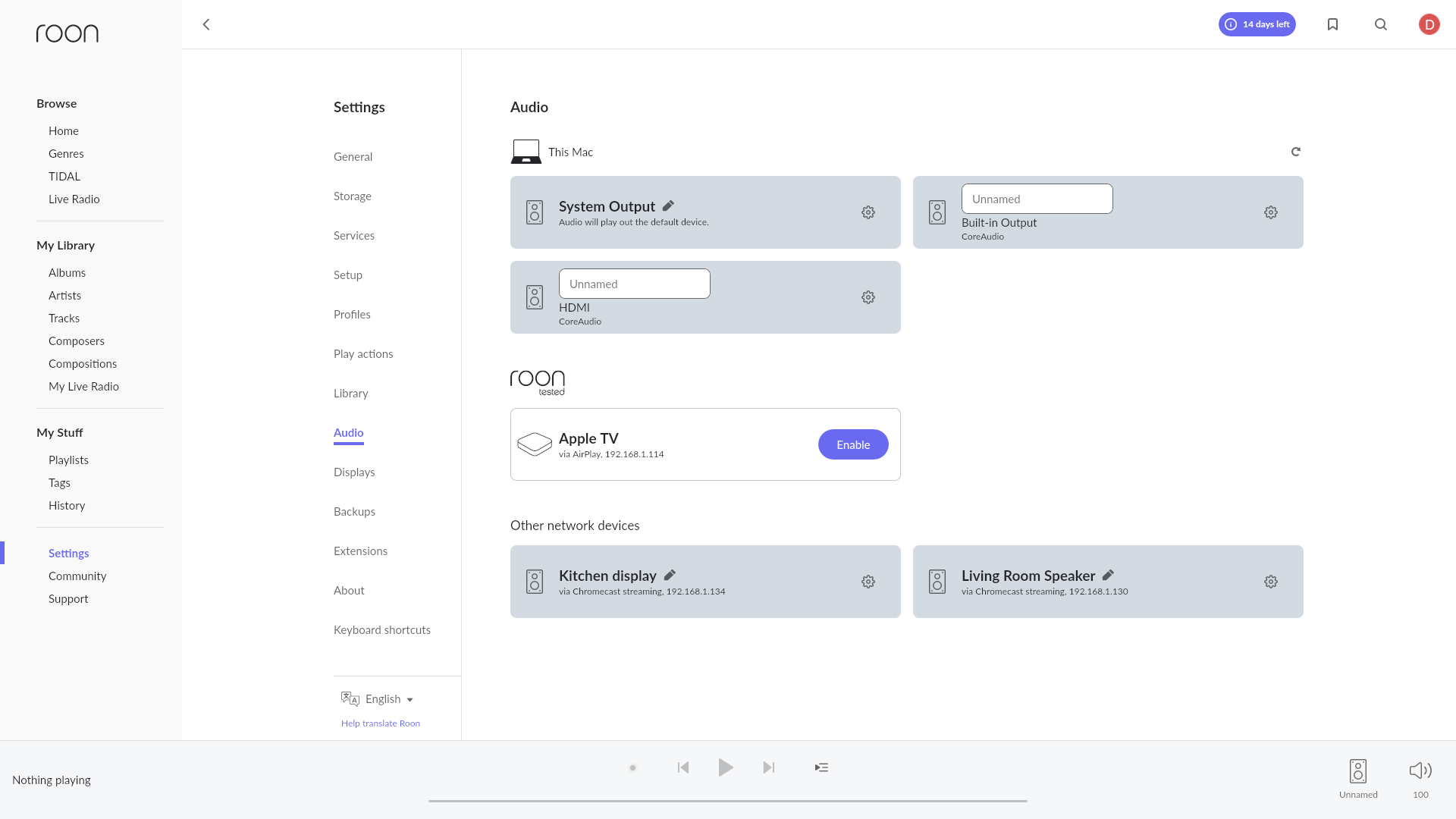

I am not able to get my Marantz NA6006 to show up as an audio device.
Turn off firewall, see if you can get AirPlay to work this way.
I don’t believe that the firewall is on or I wouldn’t see the AppleTV

I connected the Mac Mini to this switch with an ethernet cable instead of the wireless connection it was using and getting the same results. I can ping the NA6006 from the Mac Mini so I know that they are on the same network subnet. I am only using the 192.168.1.0/24 subnet in my house.
