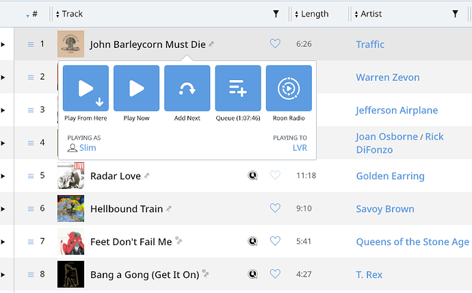

It should be as intuitive as you’d expect. Just click any of the arrows on the far left of the screen and that track will play. (this is the playlist track screen).
If you are on the Queue screen, tap the open space to the right of the album icon and "Play From Here’ comes up.
If you aren’t getting those responses, something is set up funny. It’s possible you have the shuffle function left on? Is that shuffle function blue (on) or black (off). If it is off, clear the queue and play the playlist again.
Aha, one needs to set the option in Settings==>Play Action.
In the playlist, left click on the track title that you want to start play from.
Simple, once you know.

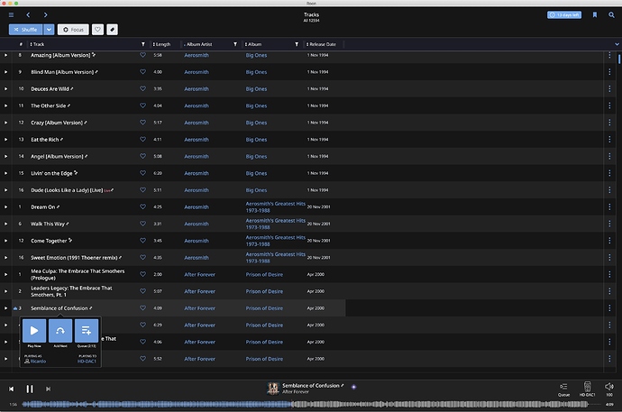

Here is the screenshot of my Roon screen - as you can see, no “play from here” option is displayed.
And to add: what has just happened after playing that track from After Forever? Playback stopped. Not really what one would expect when playing from a track list.
