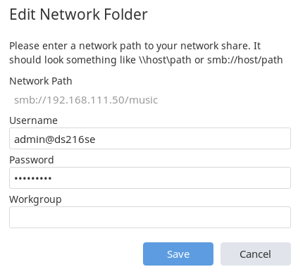

This was bugging me so I’ve been having a play, I’ve also got a Synology NAS and have smb3 enabled.
What seems to work is entering the username as user@NASNAME
This is a screenshot of mine

normally it should work by entering the path as you already did it:
(according to your screenshot)
smb://192.168.111.50/music
User: admin
Pass: ***** (your password)
