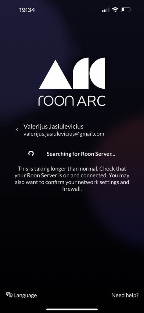

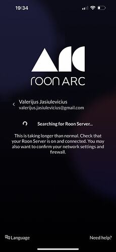

Hello, when I open ARC app on my iPhone 15 Pro max and log in, it starts login process which never ends.
Syncing with Roon Server for the first time…

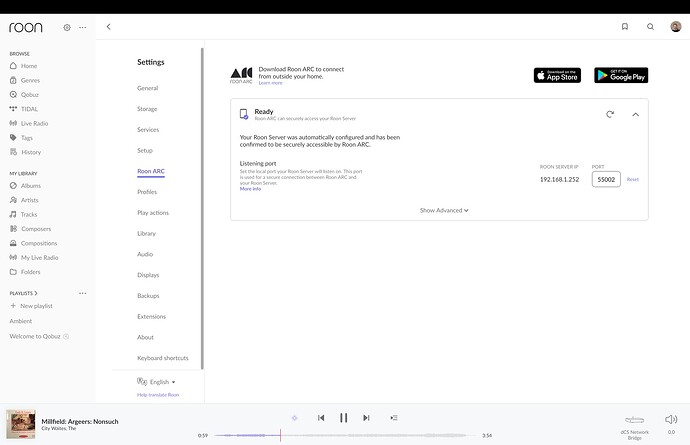

When, on Roon Desktop or Roon Remote (not ARC) you go to settings → Roon ARC, what do you see? Please post a screen shot and/or a copy of any diagnostic text displayed like:

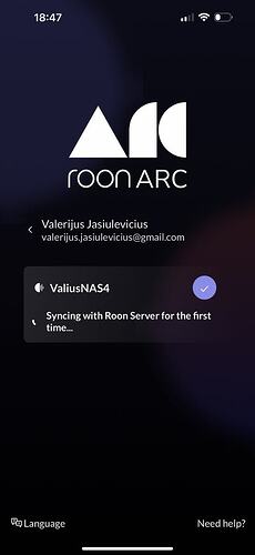

I turined off the firewall on QNAP, now the message is different, check the screenshot

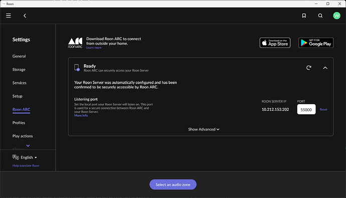

on Ronn Desktop I can see this

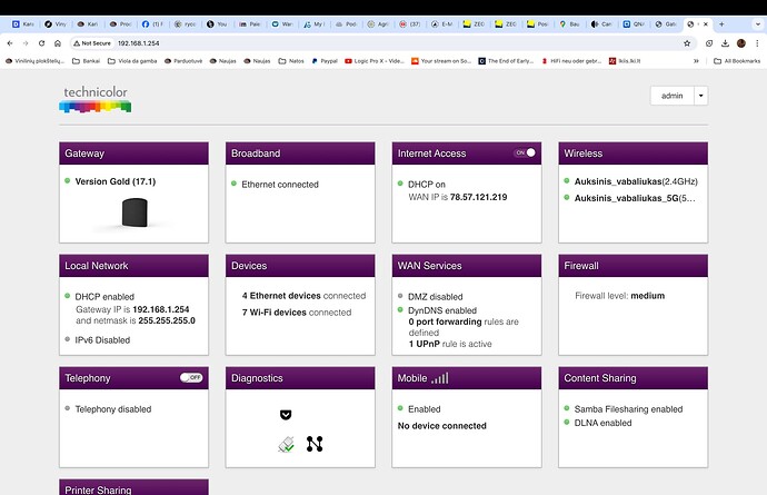

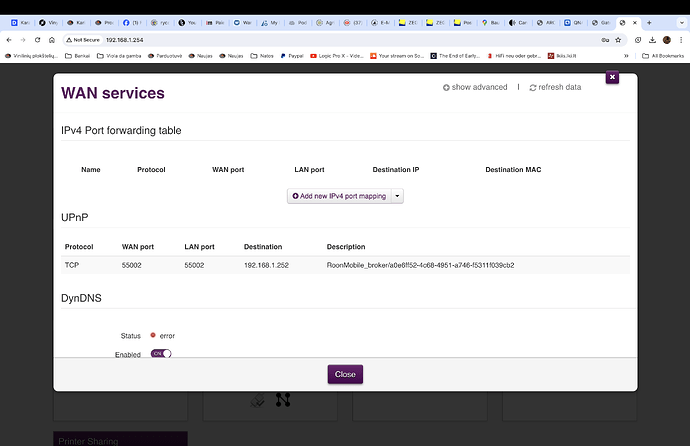

Router
It certainly looks like everything on the network side is correctly configured.

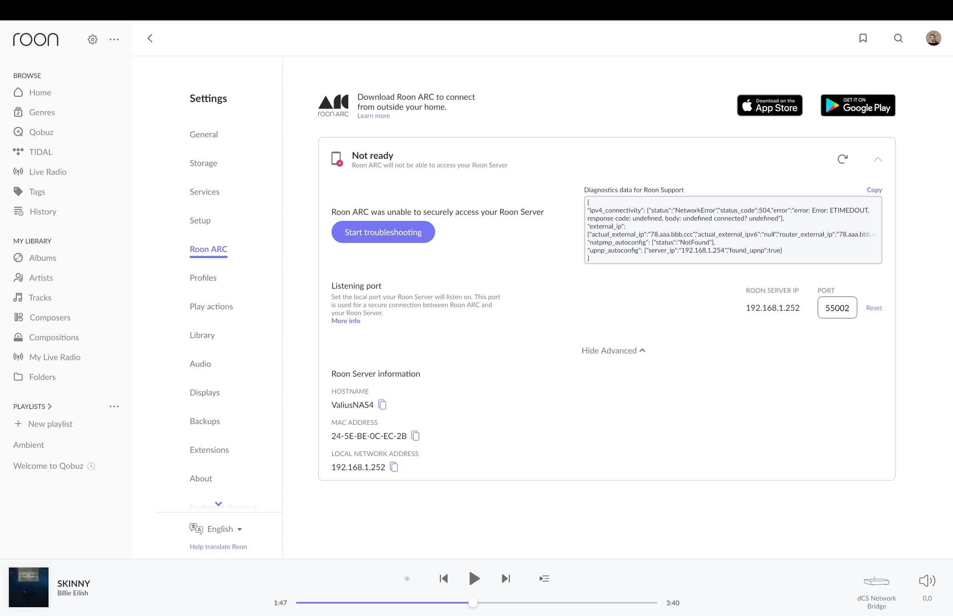

One more issue - if the firewall on QNAP is turned on, ARC fails.
How can I create exception for ARC on the QNAP TVS-4671
“ipv4_connectivity”: {“status”:“NetworkError”,“status_code”:504,“error”:“error: Error: ETIMEDOUT, response code: undefined, body: undefined connected? undefined”},
“external_ip”: {“actual_external_ip”:“78.aaa.bbb.ccc”,“actual_external_ipv6”:“null”,“router_external_ip”:“78.aaa.bbb.ccc”},
“upnp_autoconfig”: {“server_ip”:“192.168.1.254”,“found_upnp”:true}
I don’t know what the QNAP firewall configuration looks like but you will need to create an exception that allows TCP connections on port 55002.
