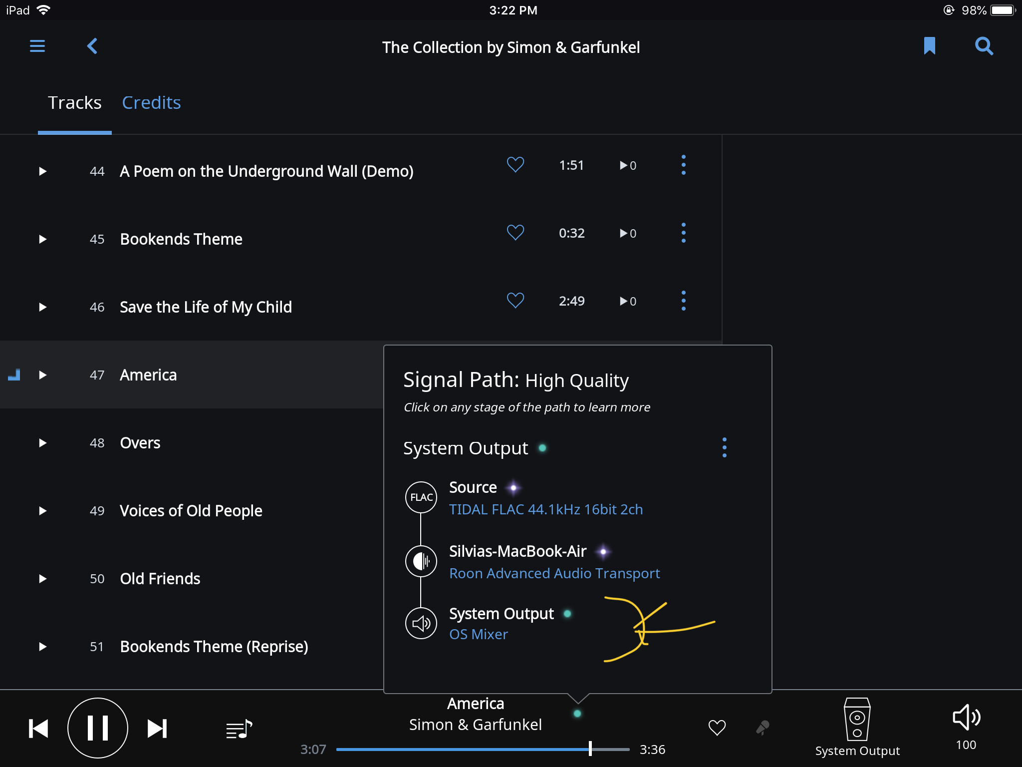

Hi, I’m streaming Tidal using Roon from my Macbook USB output into a Chord Dave USB input. The Chord Dave is set to digital preamp mode. When I click on the green light in Roon, I see that the Signal Path ends at “System Output”. Why am I unable to see Chord Dave in the Signal Path?

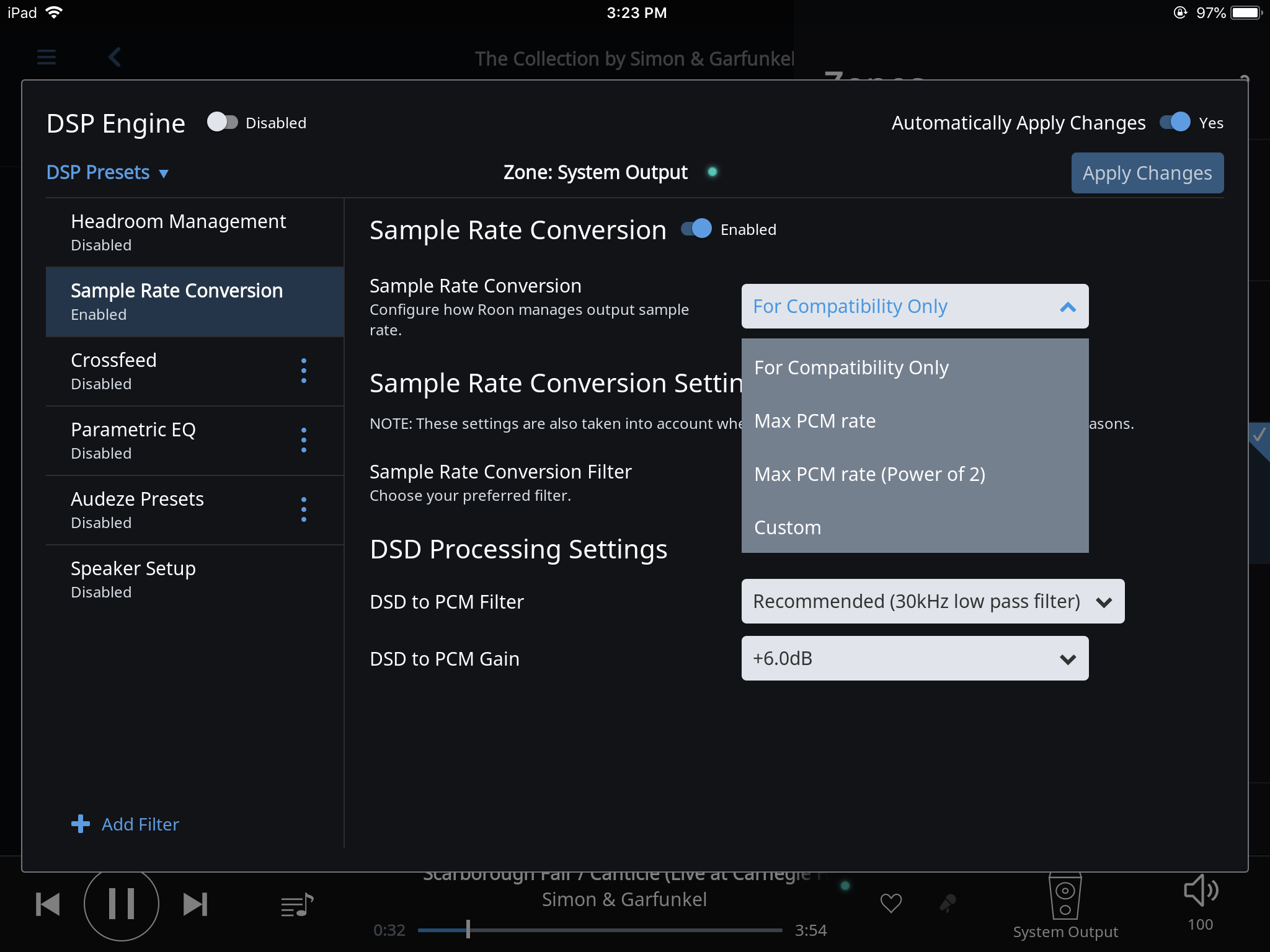

Also, I am unable to enable DSD in DSP.

Sorry - I just solved the problem - I have to enable the Dave in Audio Settings.
