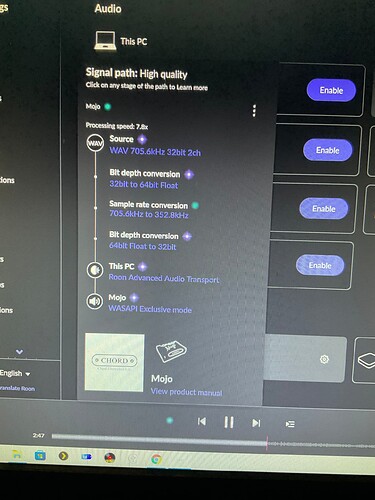

Roon output set to Chord Mojo. WASAPI Exclusive mode on. No active DSP. 705.6kHz tracks all downsampling to 352.8. I can’t understand why this is - the Mojo is connected via usual USB cable to appropriate port on the NUC. It plays to native sample rate on the Mojo (verified by colour change on the Mojo) on JRiver.
Any ideas? Is it a WASAPI thing? Thanks for any pointers :+1:
