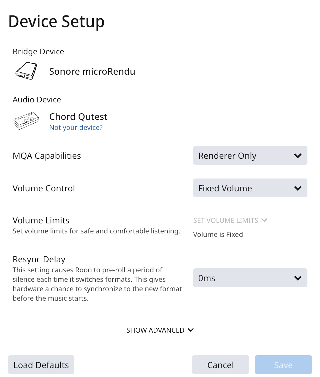

I’m using a Roon Nucleus+ to send data via Ethernet to my Sonore uRendu which is USB connected to a Chord Qutest. When setting up the device in Roon settings I am presented with:
In device setup I see:

I’ve got pretty much the same setup as you except I’m using ROCK on an Intel NUC rather than a Nucleus. What I’m noticing is that under device setup for Volume Control you have “Fixed Volume” selected, in my set up the Volume Control is “Device Volume”. In Advanced I see that you don’t have “Max Sample Rate (DSD)” between Max Bits (PCM) and Clock Master, the "Max Sample Rate (DSD) is present in my setup. You might try changing “Fixed Volume” to “Device Volume” and see what happens.

Yes you are correct my issue is the lacking “Max Sample Rate(DSD)”. I am ok with DoP if I could get there, my desire is to feed the Qutest bit perfect data and let the WTA filter do the upsampling.Your post points to a driver issue Rock vs Nucleus in my mind.

If you change the Volume Control from “Fixed Volume” to “Device Volume” in the Roon audio settings you’re not actually changing the Qutest output voltage level from the dac to the preamp/amp. The three output voltage levels you mentioned can only be changed within the Qutest using it’s own controls in the first 30 seconds while the Qutest powers up. Changing the Volume Control from “Fixed Volume” to “Device Volume” is safe and easy to reverse if you need to.
It’s possible that the Nucleus has different linux drivers than the ROCK, you’d have to check with Roon. As I remember when I first connected my Qutest to the Rock I had to play around with the Roon settings to get DoP to work. For some reason I seem to remember the trick was having the right Volume Control settings in Roon.

Ok did a full power down in lieu of just a Nucleus reset, waited 10 minutes with Qutest connected directly to the Nucleus via USB and when the core came up the DSD options were there. I had set the DAC to device volume prior to bringing the Nucleus up. Now the test will be to bring the Qutest back to the other system, (the one it is intended for) and connect it via the Sonore uRendu, and see what happens. Does anybody have the Qutest connected via a Rendu see the DSD options? I will report back.

I have the Qutest connected to an ultraRendu. Have your Qutest & Nucleus powered up and connected to your uRendu before you power up the uRendu. Then go through Sonicorbiter to get to the uRendu page and under “Settings” go to “Roon Ready”, for Audio Device select USB output, for Volume Control select None and for DSD Support select DoP, then click Save Changes. Next go to “Apps” and select “Roon Ready” then click on Restart Roon Ready.
When you open Roon’s Settings and go to Device Setup for the uRendu you probably won’t see the DSD Playback Strategy menu from when the Qutest was connected directly to your Nucleus but under the Show Advanced you should see Max Sample Rate (DSD). I’ve got that set for Up to DSD256.

Set the DAC to device volume in Roon, and the Rendu Volume control to Hardware, or None is what seemed to work. I have no idea why, but I can now let the WTA filter do its magic. Thanks to all who helped. I hope this helps the next guy.
