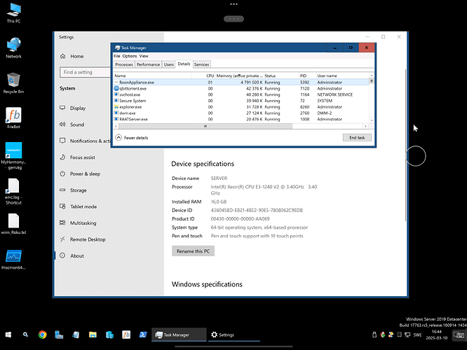

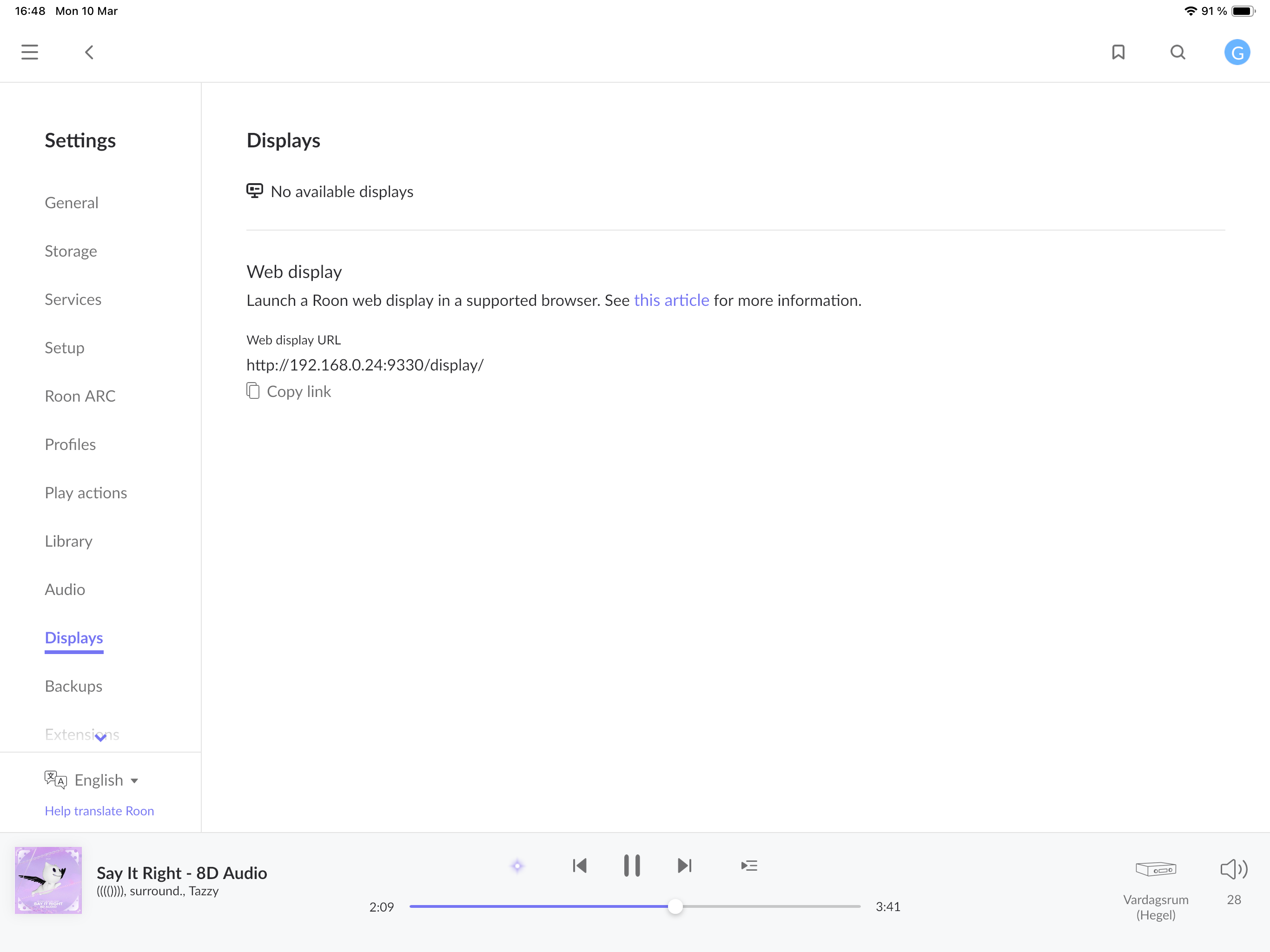

To add some additional info:
After a reboot of the server or restart of roon services the ”Display” (Google nest hub) is present and usable.
But it dissappears after about a few hours from roons ”Display” list.
Even when missing from Roons ”Display”-list the Nest Hub is availabe to cast to from ALL OTHER DEVICES (apple tv wired, iphone wireless etc.) both wired and wireless, it is only Roon that ”forgets” the device.

There, it has dissappeared once again, hopefully that is visible in the logs.
I left the units playing and went to bed at about 21:00 yesterday (March 10th) and this morning the Display device was again missing from roon.
