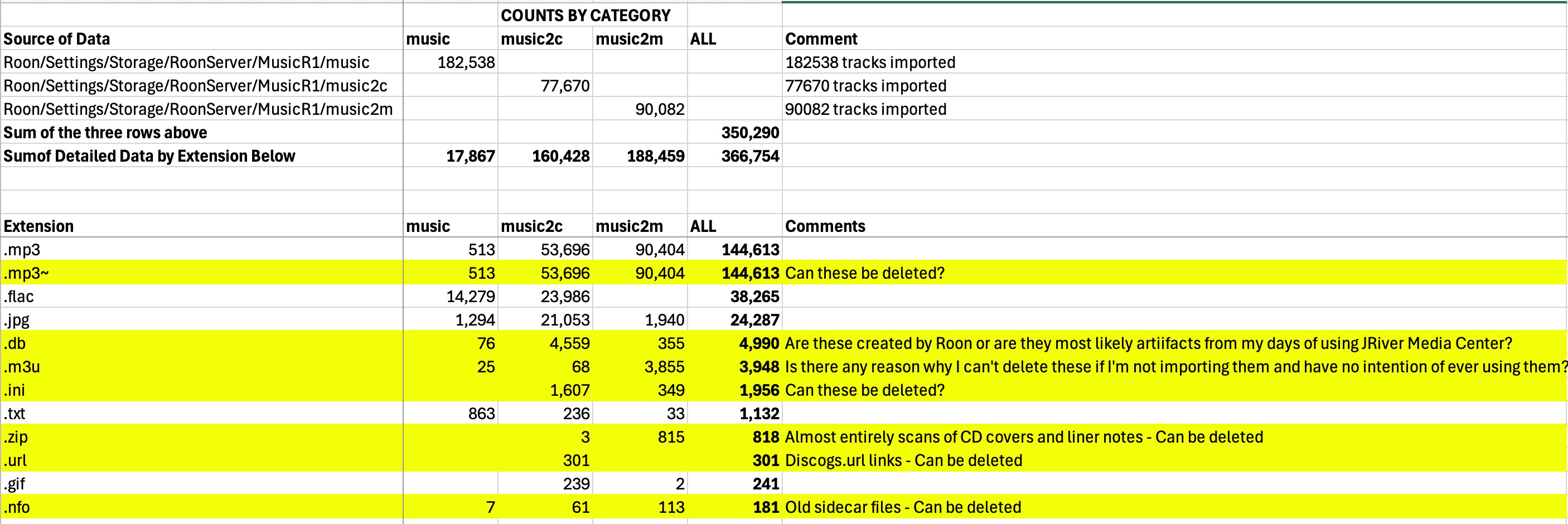

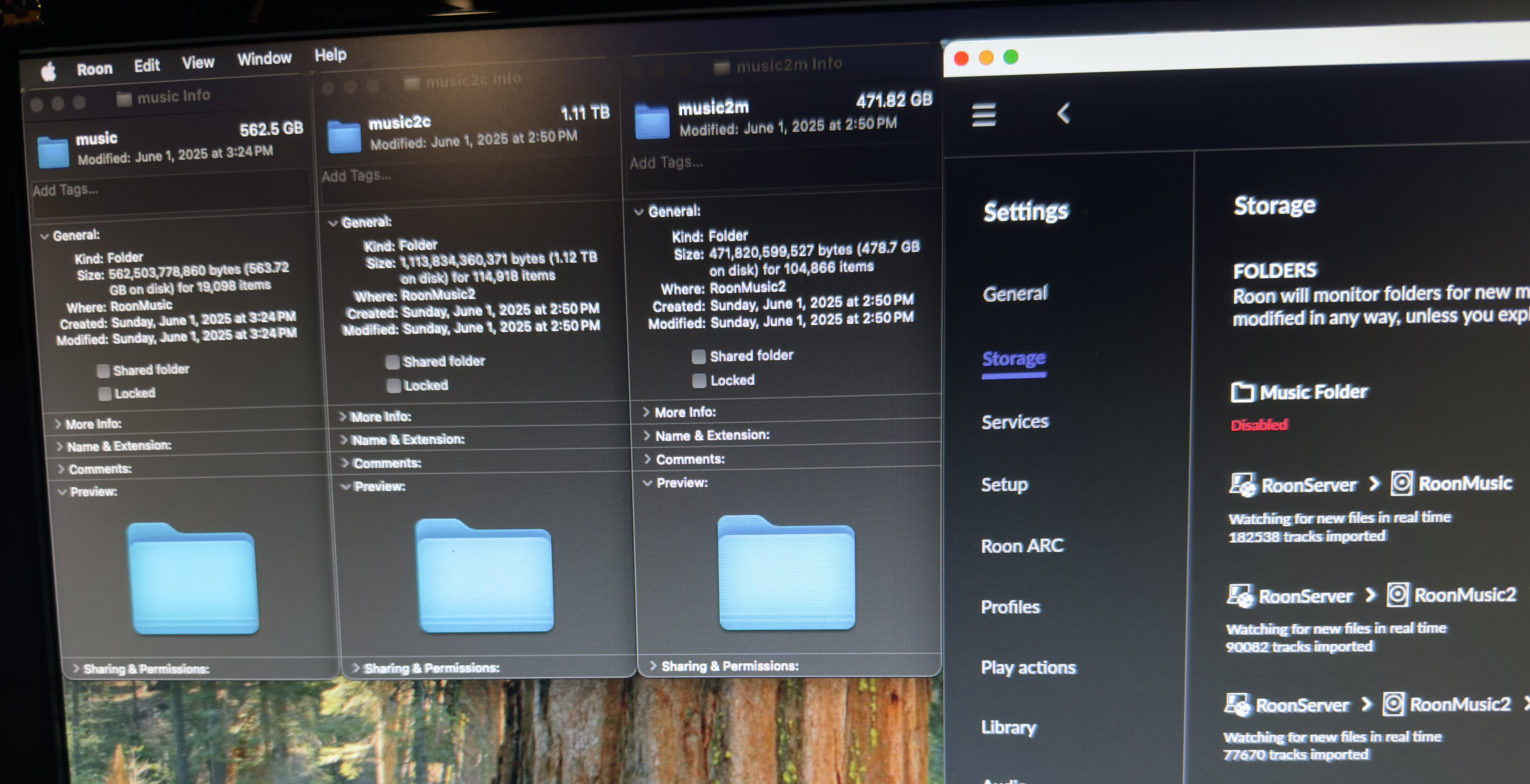

I am trying to understand how Roon is counting library content. I have my music library that is contained in on two separate drives in a total of three folders. As seen in the screenshot, the folder labeled “music” has 19,098 items in it while “music2c” has 114,918 and “music2m” has 104,866. Yet if you look to the right, it shows that the volume RoonMusic has 182,538 tracks imported (nearly ten times the number of items on the drive) while RoonMusic2/music2c shows having 77,670 tracks imported when it has 114,918 items in the folder, and RoonMusic2/music2m shows having 90,082 tracks imported when the folder has 114,918. And to make matters more confusing, the Roon home screen shows 3809 artists, 25585 albums, 356727 tracks, and 265 composers. How can a total of 238,882 items in the three folders end up showing a total of 350,290 tracks imported on the Setup-Storage screen and 356,727 tracks on the home screen. I hope someone can help me make sense of how these numbers add up. Thank you!

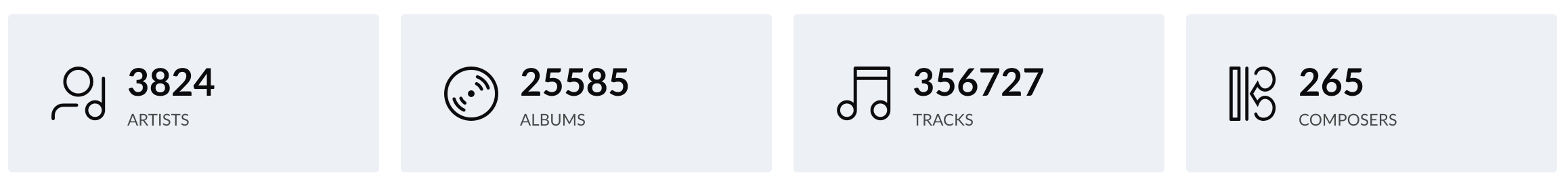

How is this looking in the front page ? Do # of tracks make sense there?

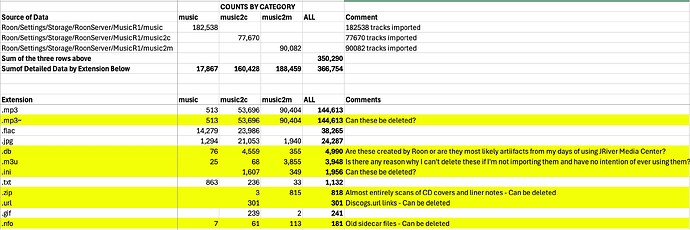

Thank you ALL for your insights. Based on what you provided, here’s what I’ve been able to identify.

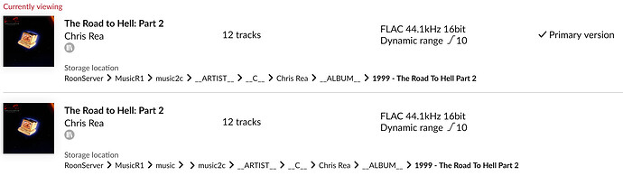

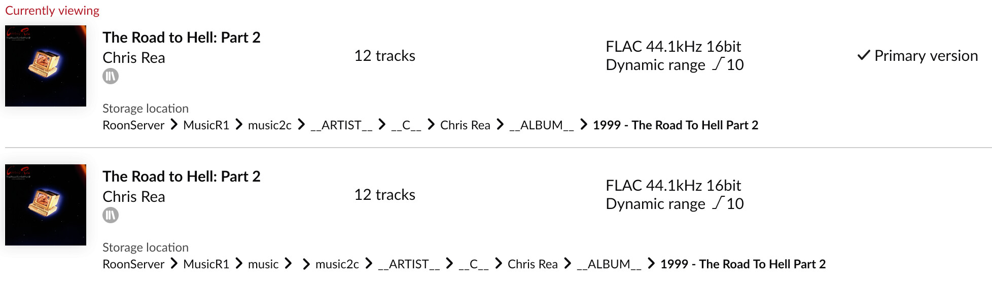

  1. I did find a limited number (31) of .cue sheets. But when looking at the individual files I found they were all small (~2k) files and the .flac files in the same folder were described by the text content of the .cue files. When looking at an album with a .cue sheet in Roon, I see two versions of the album with a phantom directory inserted (see the second version between “music” and “music2c.” While these aren’t accounting for the large disparity in the counts, can they be deleted?
  2. Symbolic Links or Folder Aliases - I didn’t find any of these myself but did run the Settings->Library->Clean Up Library twice. The first time there was nothing present. The second time I checked it had found 3 deleted files. When viewing skilled files, Roon was able to identify 410 files that were either a non-supported file type (2 wav files), corrupt files (383), failed to extract tags (23), i/o failure (1), and unable to load image (1).
I also ran a full “find /Volumes/…” on each of the three and output the results to a text file. I then had ChatGPT provide counts of each file type. What I found provided some additional insights and questions.
  1. 100% of the .mp3 files in my library (144,613 files) are duplicated by a file with an .mp3~ extension. Could these be causing the increased counts? Can they all be deleted?
  2. There are 4,990 .db files. Are these created by Roon or are they most likely artifacts from my days of using JRiver Media Center on a PC?
  3. There are 3,948 .m3u files. As I’m already not importing them and have no intention of using them, is there any reason why these can’t be deleted?
  4. There are 1,956 .ini files. Can these be deleted?
  5. There are 818 zip files, 301 url files, and 113 .nfo sidecar files. Is there any reason I can’t delete these?
Thanks again for your help. Hopefully I’m on the right track to finally get my library cleaned up!

I left out the Home Screen earlier. See below.
