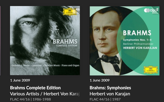

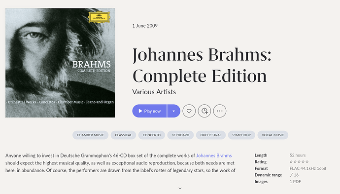

I take this as an example, but it happens actually to many of my “Complete Works of Composer X” CD-Boxes.

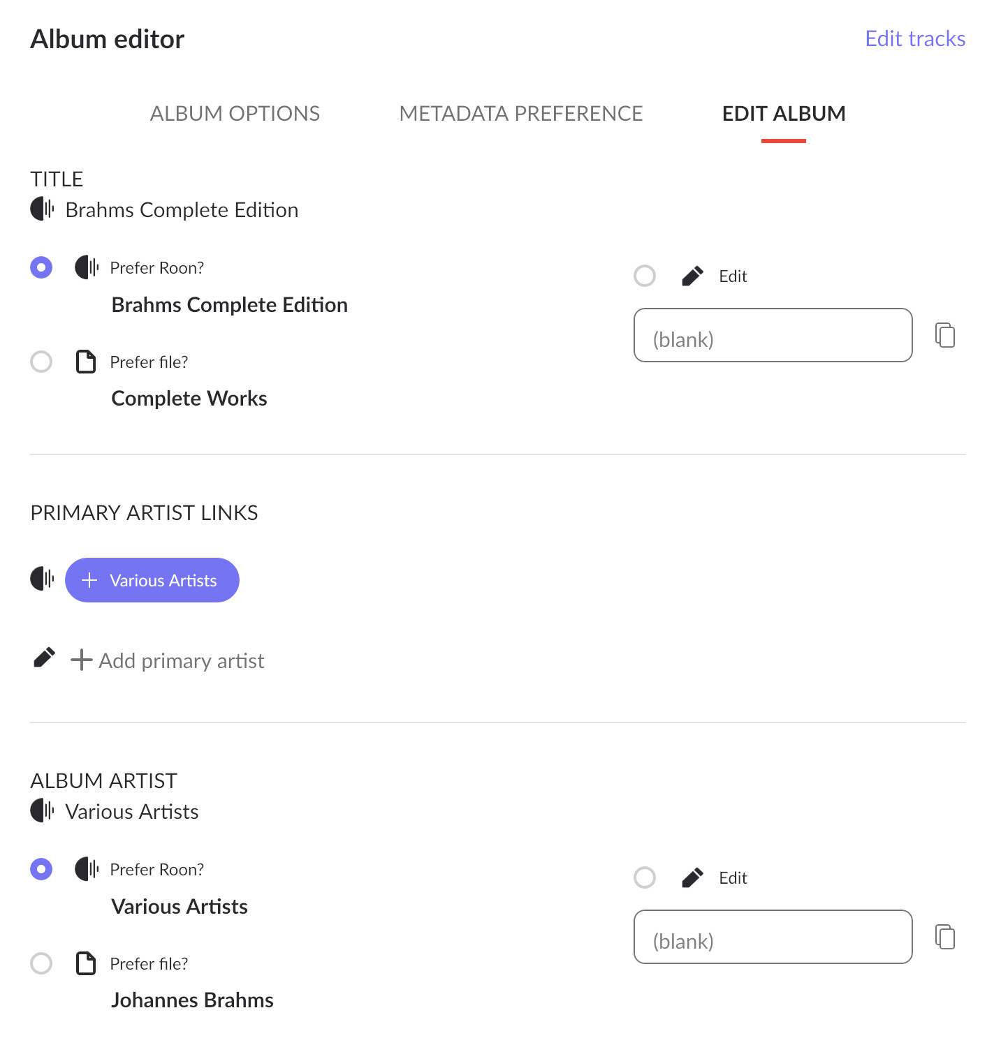

I rip the CDs and add them to the internal storage of my Nucleus. Roon identifies them and tags them correctly (like on the screenshot).
If I search for the composer’s name, these compilations don’t show up. If I search in the “Album Category” they do.
Okay, I thought that maybe the “Various Artists” of these compilations are the problem. So I manually added the composer’s name. But that doesn’t change anything. If I search e.g. for “Brahms” I can see all of my Brahms CDs…but not the “Complete Edition”.

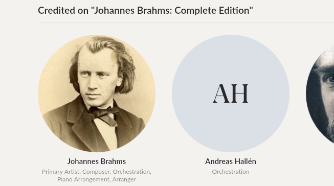

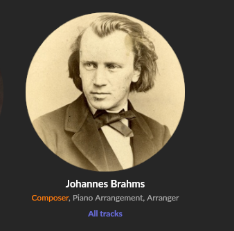

I think we’d need to see the CREDITS tab of the album. E.g., is Brahms added as a Composer credit?
Yes.

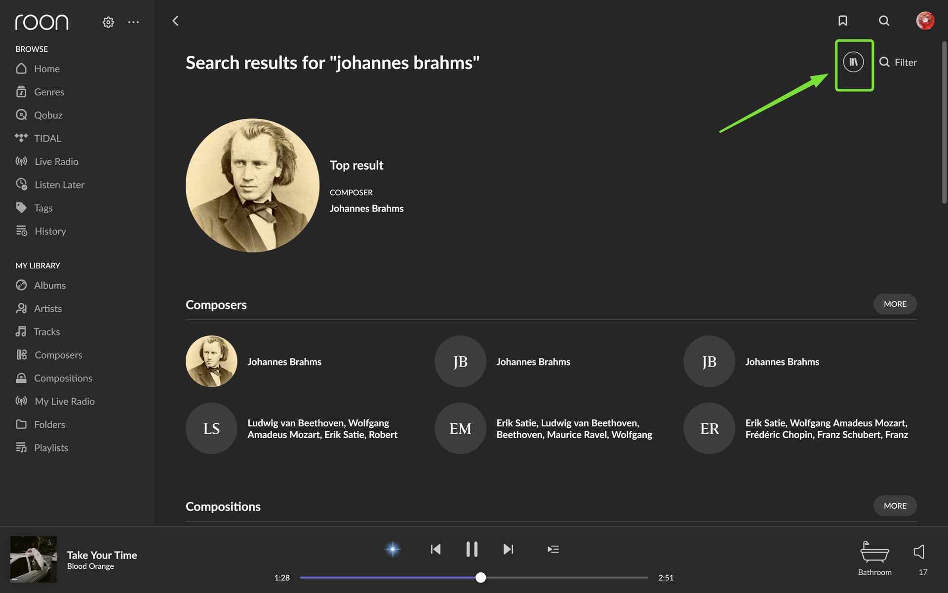

Then maybe the problem is simply the common issue that there are probably tens of thousands of albums where Johannes Brahms is a composer, but the search results are limited to 50.

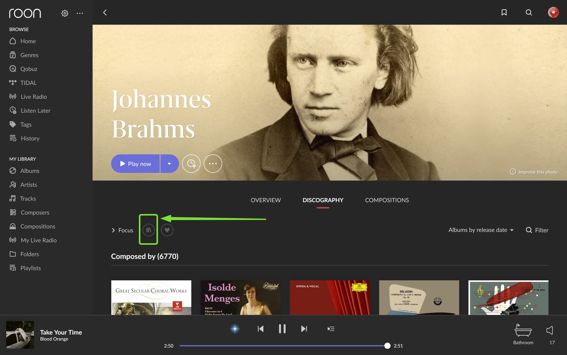

You could try limiting the search results to albums in your library. It should show up then (at least if you don’t have too many in the library):

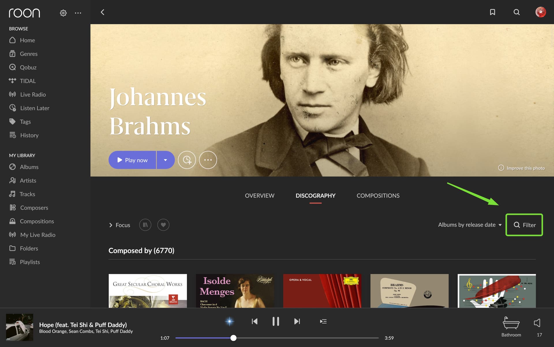

Maybe it helps if you use a filter on the search results (possibly combined with limiting to your library?)
Or maybe go to the artist page and limit to your library there:
You could combine this with a filter

Can you check if Johannes Brahms is showing as a Composer in this box, DG have a nasty habit of making the composer an Artist
If Brahms isn’t in a Composer tag it may explain
My version of this box isn’t in Roon but I would have corrected it long ago anyway
Yes, he is.

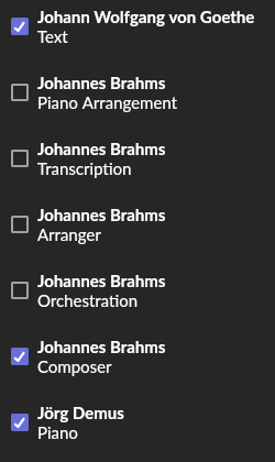

You need to remove Johannes Brahms as a primary artist. This is a performer credit from roon’s perspective, not a composer credit so it throws roon’s categorization algorithm. It’s not clear if that credit came with the box or it is something you added yourself? Roon is able to classify most contemporary performer/composers like Leonard Bernstein properly most of the time with both composer and primary artist credits (although I still find less famous edge cases roon doesn’t catch). But it is not expecting composers long-dead before the advent of recording like Brahms, Beethoven, Mozart etc. to have performer credits.
I can see Brahms has a lot of other arranger and orchestration credits, besides composer, and maybe others as well that are not on that screen, so you may have to experiment if you have come to roon with tagging habits you picked up along the way which worked with other digital players but not with roon.

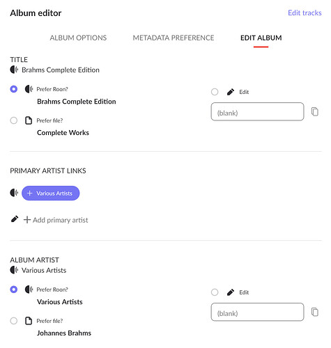

Brahms is not a selected as a primary artist. If so his name would be displayed next to “Various Artists” in my first screenshot. I once added him to see if that changes anything. I didn’t so I removed him again.

Yet in the second screenshot that you posted, Brahms is credited as a Primary Artist… I suspect that one or more of the tracks has had this set.

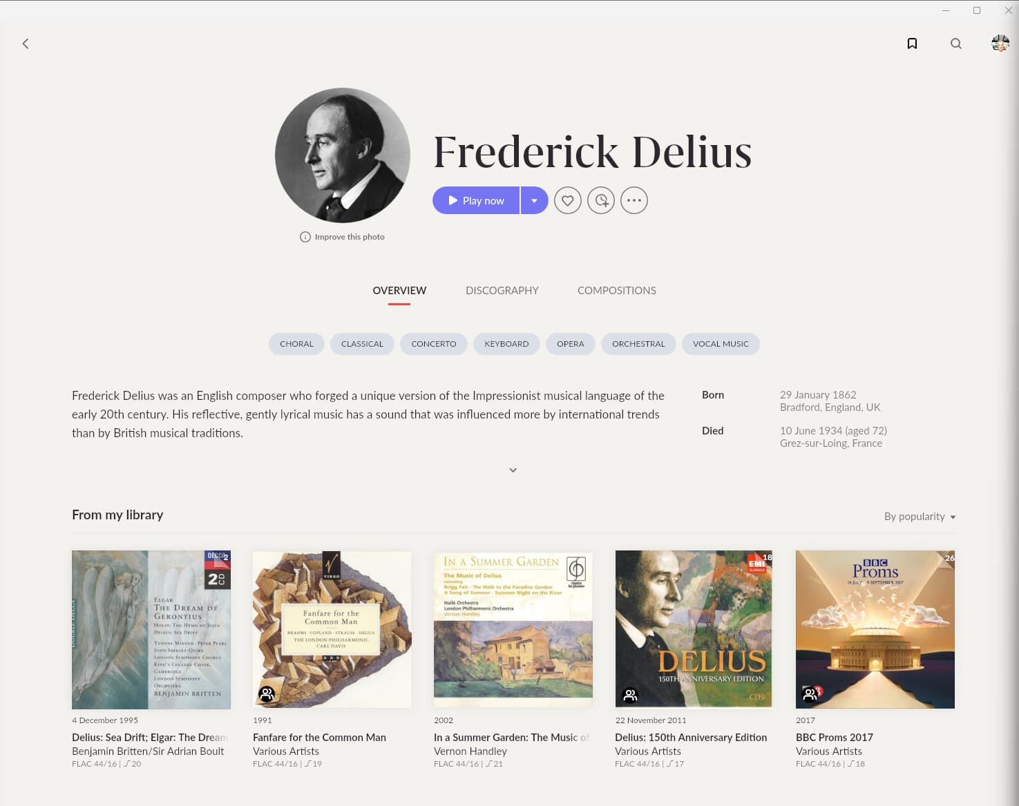

It’s odd that the boxset is not showing up on his Composer page. I have compilation boxsets dedicated to a particular composer with “Various Artists”, and these show up correctly; e.g.:

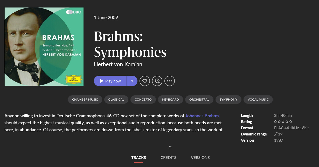

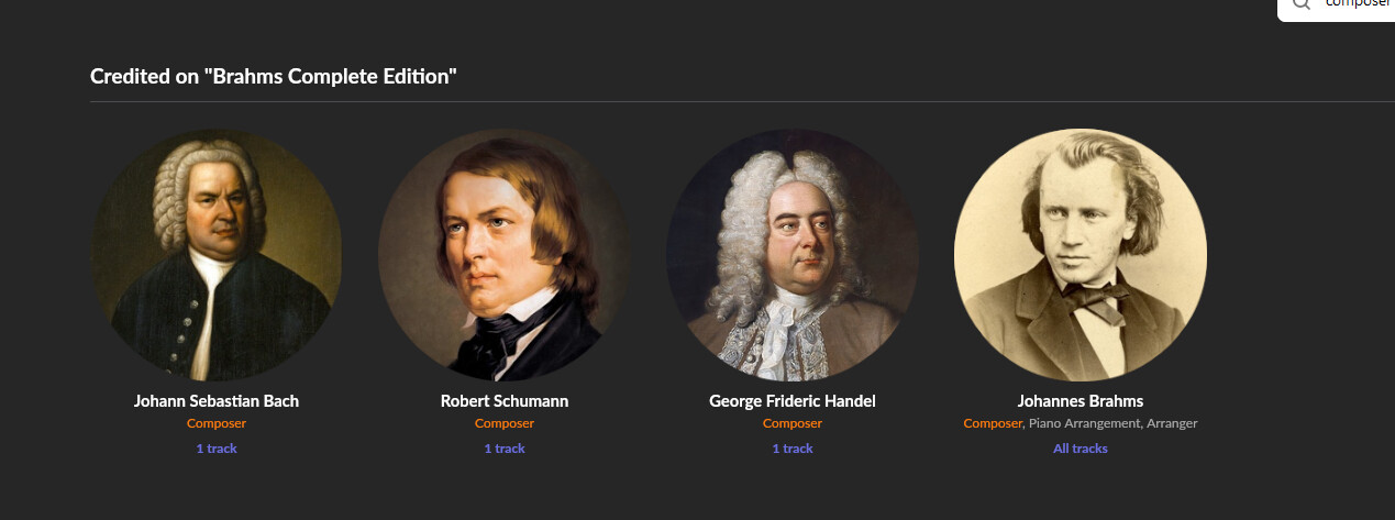

If you look in credits you find 4 composers , associated with variations. In my metadata there is no multiple composers and no reference to the other 3
go to each of the other 3 and the Brahms Box shows up. This is Handel (the Karajan shows the same pattern, see the text, maybe that album was extracted from this box and took it’s credits with it !!)
Indeed it has the ID has associated this with the Brahms box and not the Duo album
Brahms is the only one not showing . Its the only showing multiple credits. SO I edited out he multiple credits
SAVE but still shows multiples
