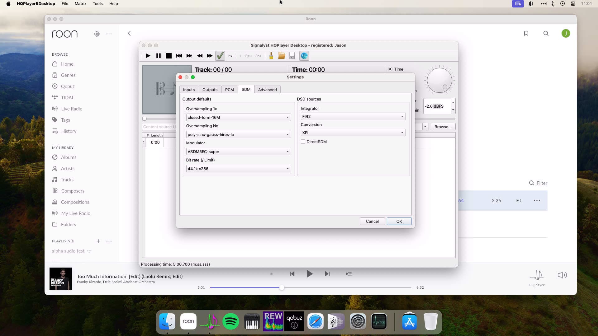

I am running Roonserver and HQPlayer on an ethernet connected Mac Mini M1 and then Roon Remote & NAA on a MacBook M2 connected to wifi, all on the same network. I have a Sennheiser HDV 820 connected to the MacBook M2 as my dac amp.
Could you advise on optimal settings for the HDV 820 please? I have attached screenshots of how I have configured this myself, based on info I have been able to find. I am currently hearing interference when I switch between tracks.
The 1st screen shot doesn’t show the HDV 820 because whenever I open Preferences to change the configuration, there are no Devices shown in the dropdown. If I press Ok & then go back in, I see a list of Devices & the one selected is not the HDV 820. So, my Device configuration doesn’t persist.
One other thing is that there is few seconds delay between me pressing Play, Pause or Skip a track and the action happening.
Best wishes, Jason

I would output DSD256 with ASDM5EC-light for example.
The HDV 820 should mute it’s output in such points. But with Roon, I recommend to set “Idle time” on Advanced tab for example to 30 seconds. This way Roon is not all the time stopping and restarting HQPlayer’s playback engine and subsequently the DAC when you just want to switch tracks or seek around. Makes interaction much snappier too.
There is some problem with HQPlayer installation on your Mac. Did you install it in the Applications folder? Please also check System Preferences / Security & Privacy so that HQPlayer has been granted all the needed permissions. Now there seems to be some issues enumerating the devices and possibly also storing the settings.

Sorry, I’m not sure how to do this, even having read the manual pdf. Mitch doesn’t use HQPlayer, so I’m not sure he can help me with this setting. How does it affect the effectiveness of the convolution filterset I’m using?
I’ve updated the “Idle time” as you suggested. I’m still hearing hiss with interference before music tracks start, although perhaps for a shorter time period.
Yes, HQPlayer is in my Applications folder. I added disk access and media access in System Preferences / Security & Privacy. Are there others I should add HQPlayer to particularly?
