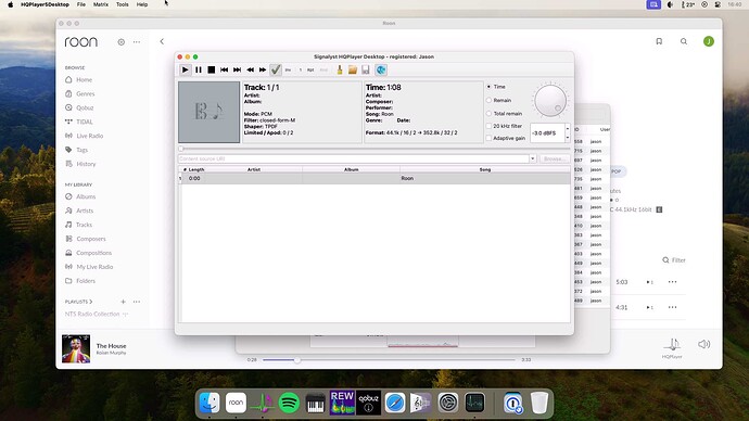

I’ve just timed this & it’s taking 15 seconds (!) from me pressing pause or play for the pausing or playing to happen. When I disable the Convolution filters, this time drops to 12 secs.
Yes, it is about 4 dB under, so it is completely fine without gain compensation. You could even apply a bit of positive gain compensation to it (3 - 4 dB), as long as you keep HQPlayer volume at no higher than -3 dB (recommended).
I think I inadvertently checked the Log file option. When I uncheck this, the delay is back to six seconds. Is this a typical delay & how can I reduce this? It does interfere with my experience of playing back music somewhat…
Thanks for your message @Stefano_Antonelli. I have just tried this change & the delay is now ~4-5 secs. What’s the constraint here, is it processing power or RAM or something else?
It can depends on both, but here is always a little delay.
The delay should be on the first track only if you let play your play queue without jumping from one track to another one
I have never seen any delay caused by logging. Storage device would need to be horribly slow, or some other process intervening the file access for it to take several seconds to write couple of lines text (few hundred bytes) to a file. It even goes through disk caching.
closed-form-M16 will have inherent delay associated with it, I would advice against excessively long filters unless you have a strong preference for such.
You can also reduce delay by setting “Short buffer” to greyed and set Buffer time to 10 ms. This increases possibility for drop-outs, but reduces delay since there is less buffer at the NAA side.

I don’t know why the logging setting seemed to have such an effect. The MacMini M1 is totally standard and clean, only used for Roon Server and HQPlayer.

But breaks in playback are typically due to CPU overload, so if you get such, you may need to switch to lighter settings. Like closed-form-16M is potentially too heavy. I’d suggest to switch it to the default poly-sinc-gauss-long and check it the issue persists.
