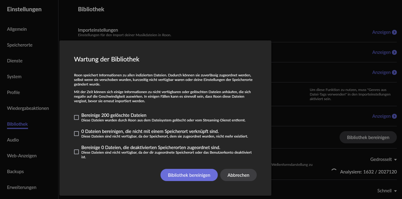

After that you can clean up your library. Even earlier something may have been moved, which is now no longer there. Library maintenance is very easy.
Why do you want to delete everything before? Should all be moved to a third still unknown hard disk? If there are already over 95,000 songs in the right place, there is no need to remove or delete this folder.
