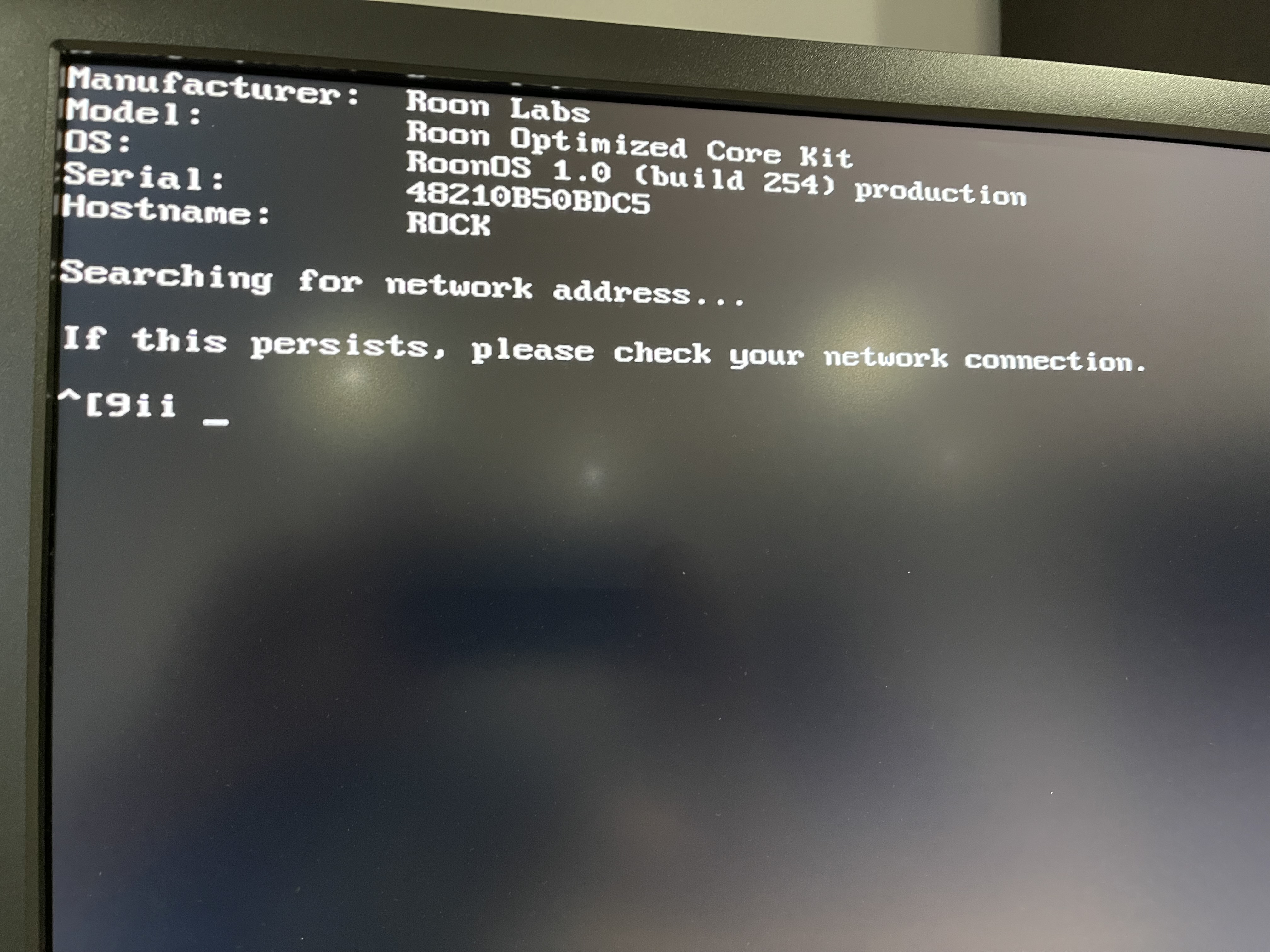

Connection issue on NUC12
Have installed Roon on NUC12WSHi7 and have this message. Anyone have the same issue?
Hi,
This suggests the NUC can’t get an IP address from your router.
Can you double check that the NUC is hardwired to the LAN.
On the NUC’s RJ45 port what at the LEDs doing?
There is no led blinking on the nuc
Can you try a different Ethernet cable?
Are you sure the one you are using is securely locked in at the nuc and the router/modem/switch it’s connected to?
And that Ethernet is live at that port.
I have tested the cable and router using a laptop and it works so I think it comes from the NUC. I was just curious if someone have the same issue as me …
DHCP enabled at your router?

To test, it might be an idea to make a live USB of an up-to-date Linux distro and try it out. Something with a recent(ish) kernel should do the job, Ubuntu 22.10 is running 5.19. Prepare a live stick and give it a go. If the network controller works, then you have kernel support. If not, you have (more) problems.
I have this same NUC and ROCK works fine. I had the same problem when I moved it from my audio cabinet to near my router. I had to try three different ethernet cables before I found one that worked. These were cables that I had laying around. All of the newish ones I have tried have worked. If the lights on the ethernet jack aren’t working try another cable.
