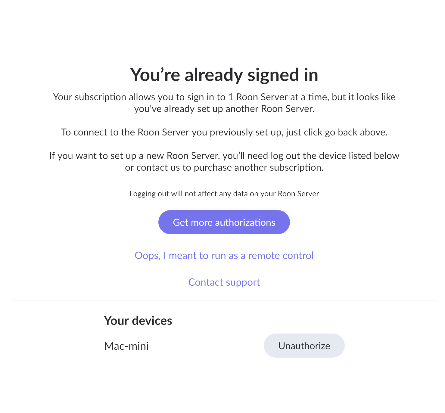

after the recent MacOS 15.4.1 update I can no longer connect to the Roon server. When I try to connect using the Roon app I am asked to login. After I login it tells me that I am already signed in and it looks like I've already set up another Roon server. There is a button for "Get more authorizations". I have been running Roon Server on this M4 Mac mini for several months without incident until this recent OS update

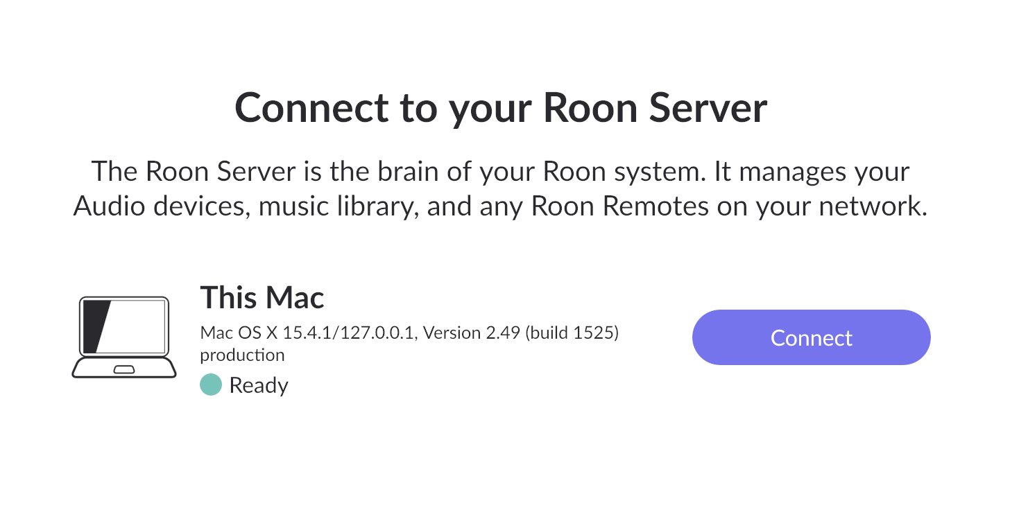

Hi, If I select “oops, I meant to run as a remote control” it takes me back to the “Connect to your Roon server” screen -

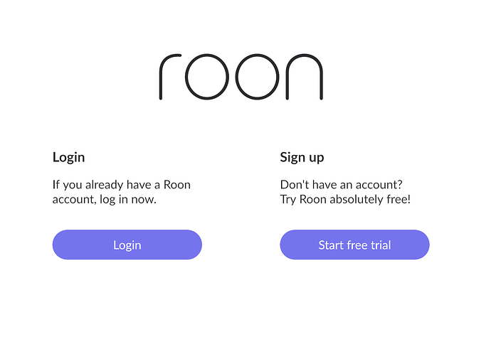

Clicking on “Connect” takes me to the login screen -
Which then takes me to the “You’re already signed in screen” - so basically going in circles.

Followed the directions, still no luck, same behavior. Client and server are running on the same machine - M4 Mac mini. Client recognizes server as seen in the screenshot above, but will not connect. When I try to connect it takes me to the login screen and then the “get more authorizations” screen.
Are you able to access your account from your internet browser on another machine and deauthorize the excess login sessions with the M4? Or even all logins to the M4?
Is this a case where the Roon Server is presenting a changed identity and so the ‘old’ identity needs to be ‘unauthorised’?
What happens if, when you get to the point shown in the first screenshot, you click on the ‘unauthorise’ button in the bottom right?

yeah that was my thought too. As soon as I clicked the “unauthorize” button it cleared right up and went back to functioning normal again. I didn’t try it right away since I was worried about messing up my installation. Thanks!
