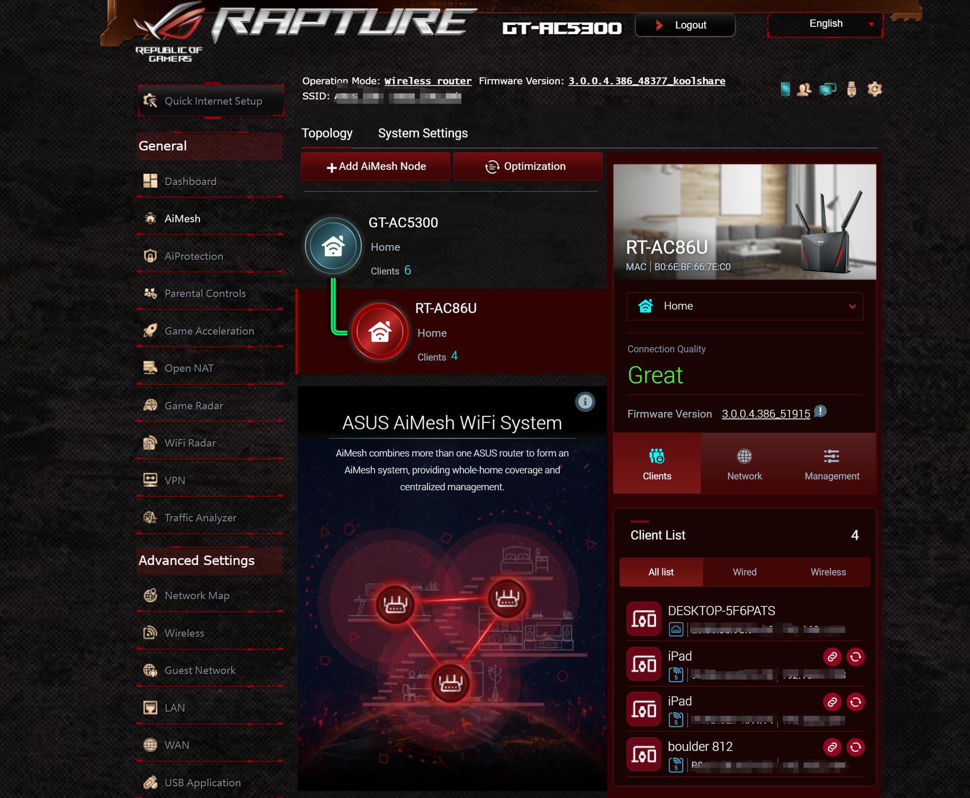

My setup consists of a Mac Mini 4 as the Roon server; a Synology 916 as the music file storage; and a Boulder 812 as the Roon Ready preamp. The main router is an Asus GT-AC5300, and the secondary router is an Asus AC86U, connected in AiMesh mode. I use an iPad Pro 2022, iPad Mini 7, and Redmi 12T Pro as remote control interfaces.
I am currently facing two issues. First, when I use the Redmi 12T Pro as the Roon remote control, I lose connection with the server when entering the Wi-Fi coverage area of the secondary router. However, if I turn off Wi-Fi and reconnect in the main router's area, I can connect normally. Additionally, Roon Arc works fine in the secondary router's area.
The iPad Pro, iPad Mini 7, Boulder 812, and a Windows host are all connected via Wi-Fi in the secondary router's area without these issues, and I can send commands to the Boulder 812 to play or turn on/off without problems. I kindly ask for help to resolve the connection issue with the Redmi 12T Pro, as it is very important to me. I do not have a second Android device to perform a reproduction test to determine if it is an issue with the Android system.
Second, after updating the Roon server version to 2.47 (build 1510), there have been very rare instances where the Boulder 812 loses connection. Even after restarting Roon, the Boulder 812, and the router, Roon still cannot display the device. This issue has only occurred once since the update and then recovered automatically. During that time, I was operating the Mac Mini 4, and I'm not sure if this might have contributed to the problem.
My English is not very good, so I asked chatgpt to help translate this paragraph. I hope your answer can be relatively simple. Thank you very much.
Best regards.
