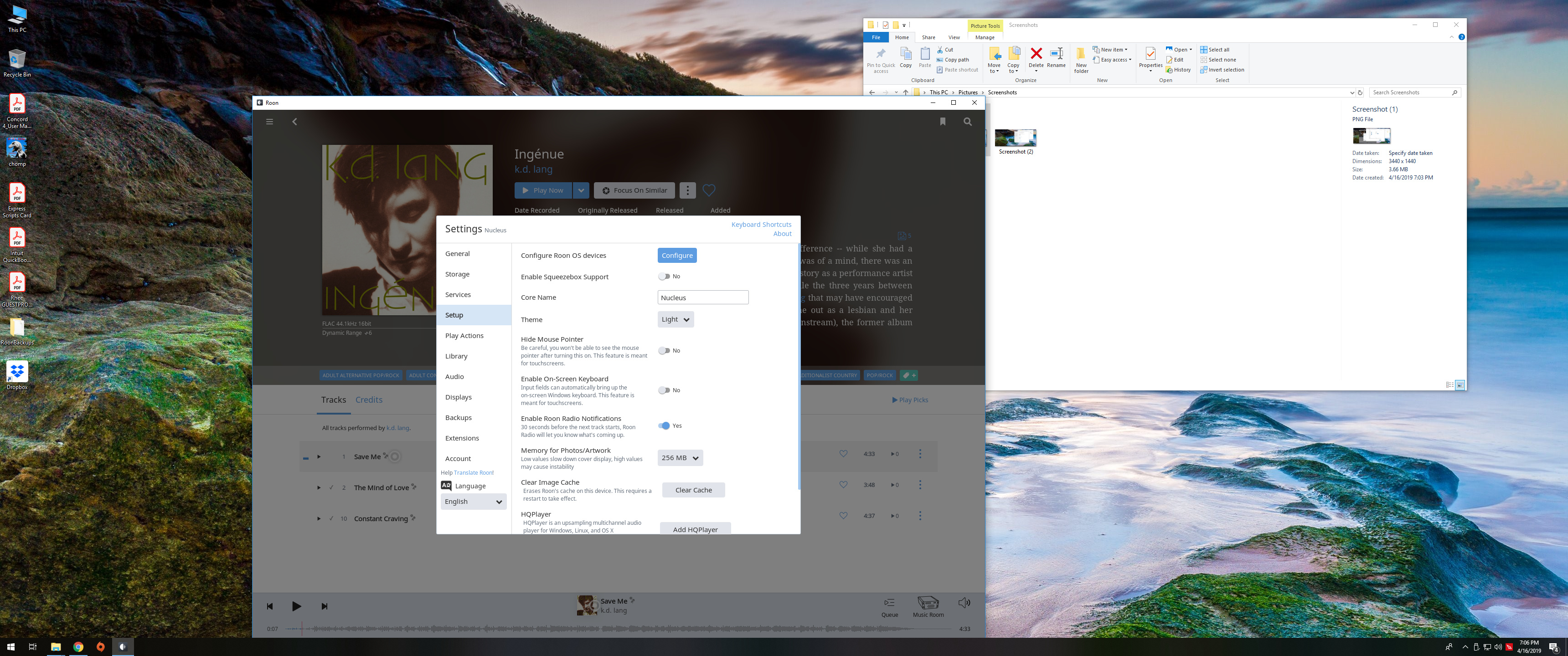

Regarding your PC not showing up as an audio device, can you please post a screen grab of the audio tab on the Roon settings page.
