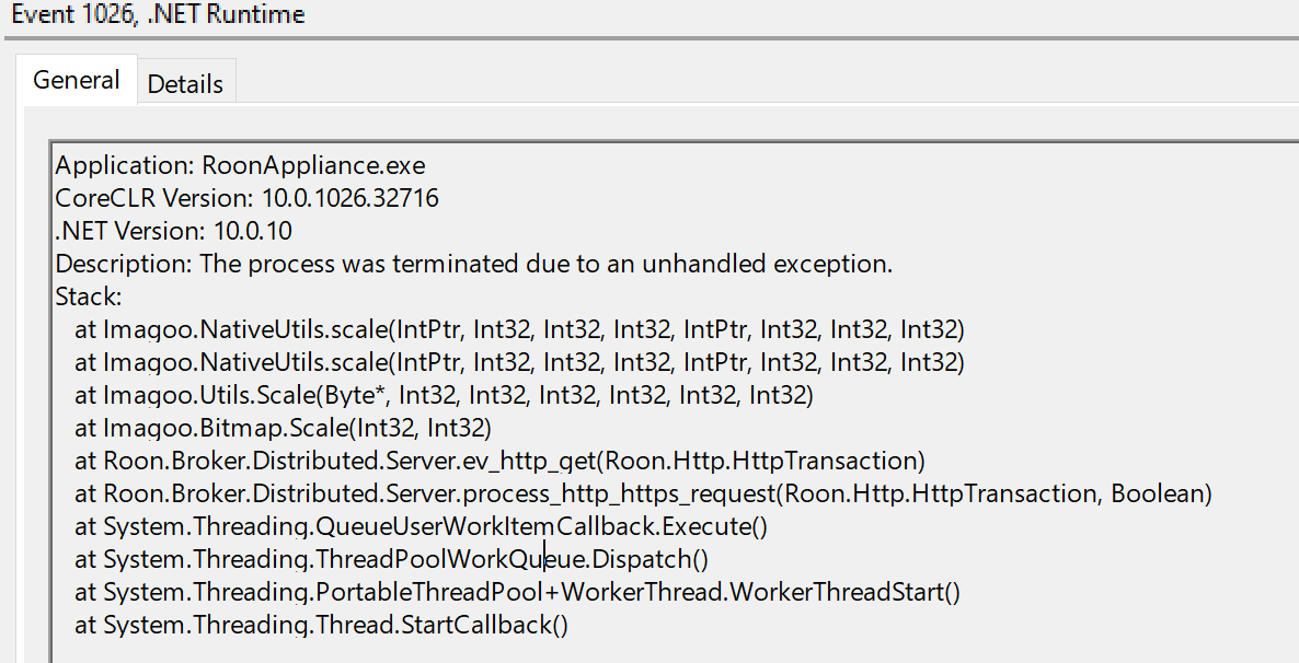

This is on ROON installation SRV. The only thing that stands out is that late this morning I started to use ARC on an iPhone and an iPad. On both devices I activated Smart download and downloaded a couple of hundred songs, just to see if things work. None of these iOS devices where in use when 2 hours later Roon crashes:
Event 1026, .NET runtime 18 Sep 2026 12:16:44
Application: RoonAppliance.exe
CoreCLR Version: 10.0.1026.32716
.NET Version: 10.0.10
Description: The process was terminated due to an unhandled exception.
Stack:
at Imagoo.NativeUtils.scale(IntPtr, Int32, Int32, Int32, IntPtr, Int32, Int32, Int32)
at Imagoo.Utils.Scale(Byte*, Int32, Int32, Int32, Int32, Int32, Int32)
at Imagoo.Bitmap.Scale(Int32, Int32)
at Roon.Broker.Distributed.Server.ev_http_get(Roon.Http.HttpTransaction)
at Roon.Broker.Distributed.Server.process_http_https_request(Roon.Http.HttpTransaction, Boolean)
at System.Threading.QueueUserWorkItemCallback.Execute()
at System.Threading.ThreadPoolWorkQueue.Dispatch()
at System.Threading.PortableThreadPool+WorkerThread.WorkerThreadStart()
at System.Threading.Thread.StartCallback()
Perhaps you can see something from your end.

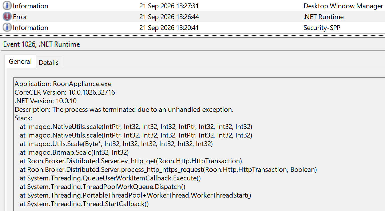

Stil getting the errors:
09/21 11:15:14 Debug: RoonServer, before attempting to start RoonAppliance binary at path: C:\Use
09/21 11:15:14 Debug: RoonServer, after starting RoonAppliance
09/21 13:26:44 Info: RoonGoer: child exited code=-1073741819 (abnormal) after 7890s of life
09/21 13:26:46 Debug: RoonServer, looking for RoonAppliance, trying: C:\Users\Peter\AppData\Local
