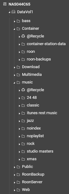

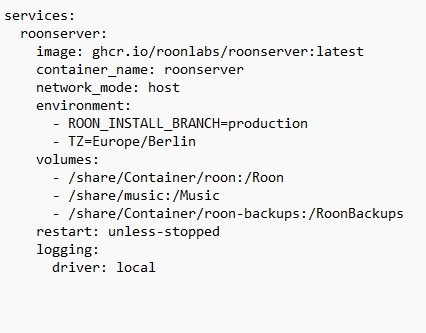

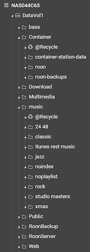

Did you make sure your :Music path in the docker generator is correctly routed to the container, and the new Music Folder appearing under Settings > Storages, is enabled?
I think I must have something wrong in the configurator. I copied the backup files as you suggested and they are visible in Roon. Just as the local files are, but I can only reindex them. BUT, the local files are not being found when I carry out a restore. Enclosed is my QNAP directory tree and a copy of the YML file.
Your folder logic and share paths look reasonable and match the structure in File Station.

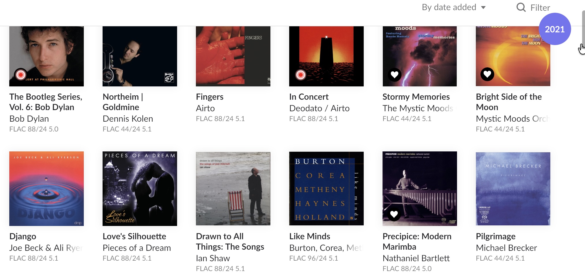

Does your method ensure that the date added remains as in the previous database? When I have tried enabling the new “Music” path, Roon simply reindexes everything it could find there. (I did not remove the old remnants, but they were disabled)
If the albums are identified as the previous ones, just moved into a new folder, this should be the case. In my case, less than 10 albums out of 3,900 were not correctly identified, the rest bears the same date/year added as before the backup:
Albums added in 2021, as an example.

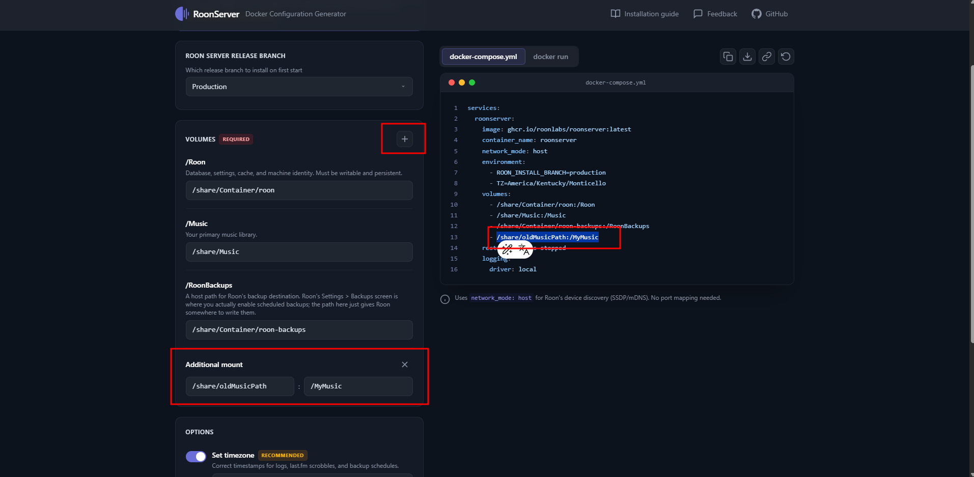

Hello @martingh and @Arindal: The “Edit” vs. “Delete” Method
While deleting old paths and adding new ones can work for identification, it often triggers a full re-index that treats your files as “new,”
The Quick Tip to preserve all metadata (Date Added, Playlists, Hearts):
Configure the Docker Container (The “Dummy” Mapping)
Before starting the container, set up your volume mappings to prevent Roon from triggering an automatic clean scan:
  • Map the default folder to a “dummy” path: Create an empty folder in QNAP File Station and map the default container music path to it.
    • Example: /share/EmptyFolder/Music
  • Add your actual music as an additional path: Map the folder where your music truly lives to a unique mount point.
2. The Roon Storage “Healing” Process
Once your Roon Server is running and you have connected via a Remote app:
  • CRITICAL: Do Not Delete Old Paths: Navigate to Settings > Storage. You will likely see your old folders marked as “Unavailable” in red. Do not click the “Remove” or “Delete” button. If you do, Roon will permanently scrub the history associated with those files.
  • Use the “Edit” Maneuver: Click the three dots next to the red, unavailable path and select Edit.
  • Point to the New Mount: In the browser window that appears, navigate to and select the unique path you created in Step 1 (e.g., the /MyMusic folder inside the container).
By editing the path instead of replacing it, you are telling Roon: “These aren’t new files; they are the same files, just at a different address.” This instantly heals the database links, preserving your edit history perfectly.
