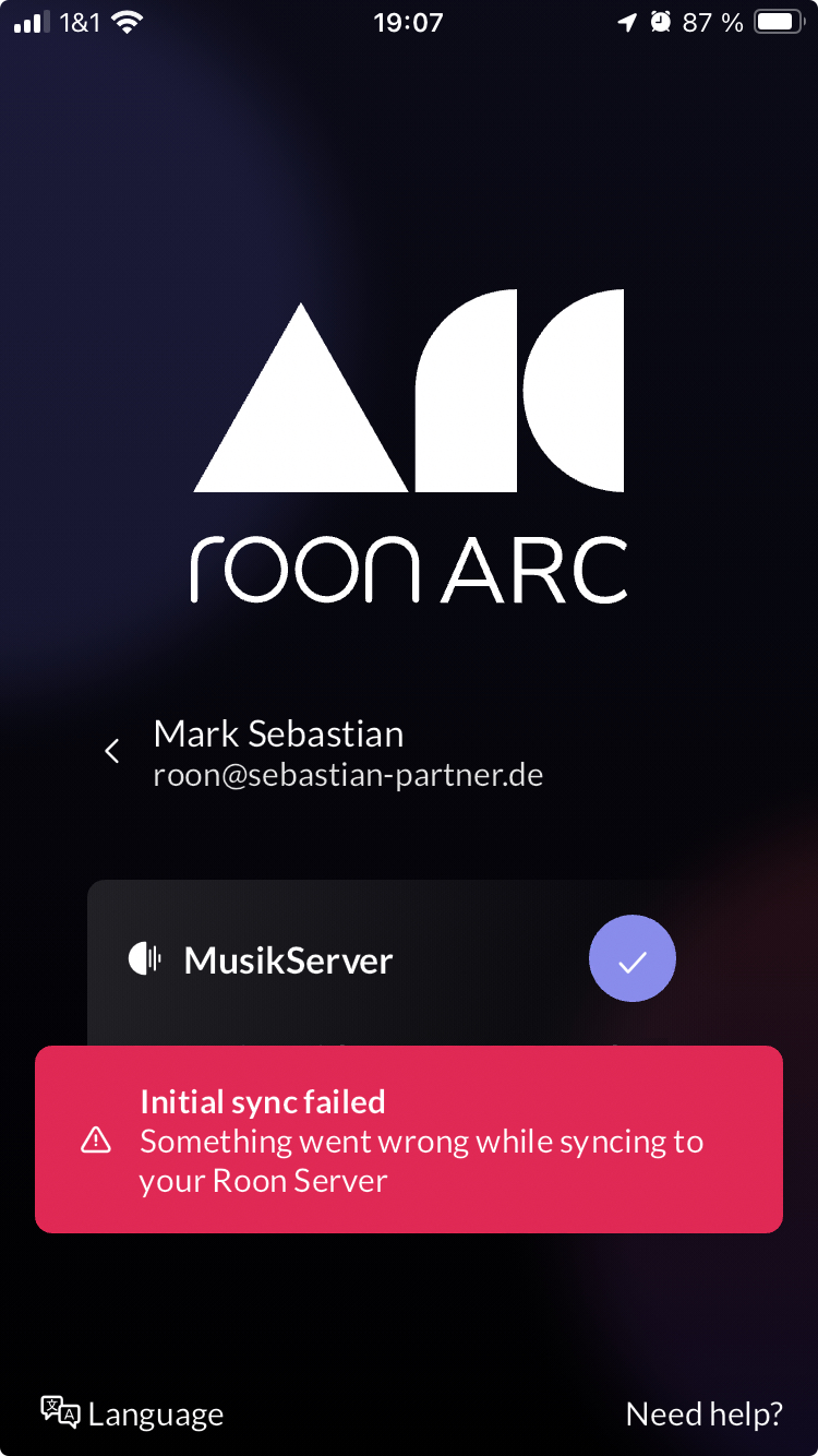

First synch with Roon Server fails
My Roon Server is visible in Roon ARC via the Internet, status is green. When I click 'Connect', the initial synch starts. But after a few seconds, I see an error message: "Initial synch failed. Something went wrong while synching to your Roon server."
I've installed Roon ARC v1.0.59 on an iPhone with iOS v17.6.1. The Roon server version is 2.0 (build 1470), running on Windows 10.
I'm using an AVM FritzBox 7490. Internet connectivity is given. Using the Roon Remote app for streaming music from my Roon Server works within the local network, both for local music files and for Qobuz as a streaming service. No problems within the local network when using the Remote app from two different devices.

Yes, I had deleted and then installed Roon ARC anew. The Roon ARC configuration from last year did no longer match the Roon server software, resulting in a static error message saying so. The new installation had the positive result of seeing the server again and connecting to it. It is the first synch after the new installation that fails persistently.
