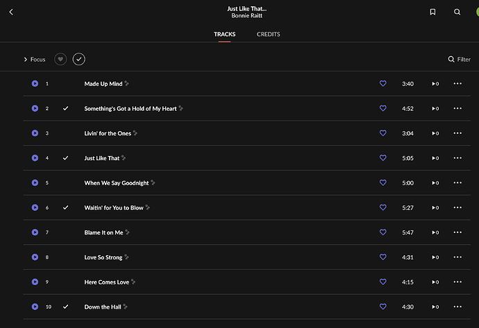

I just downloaded a couple of albums from HDTracks. One of them (Just Like That - Bonnie Raitt) had one song that was skipped. Here’s a couple of screenshots:
I then restarted the ROON server (which is running on a Synology 723+) and the song was picked up:
I have uploaded the album to the link you sent. I hope this helps track down the problem.
