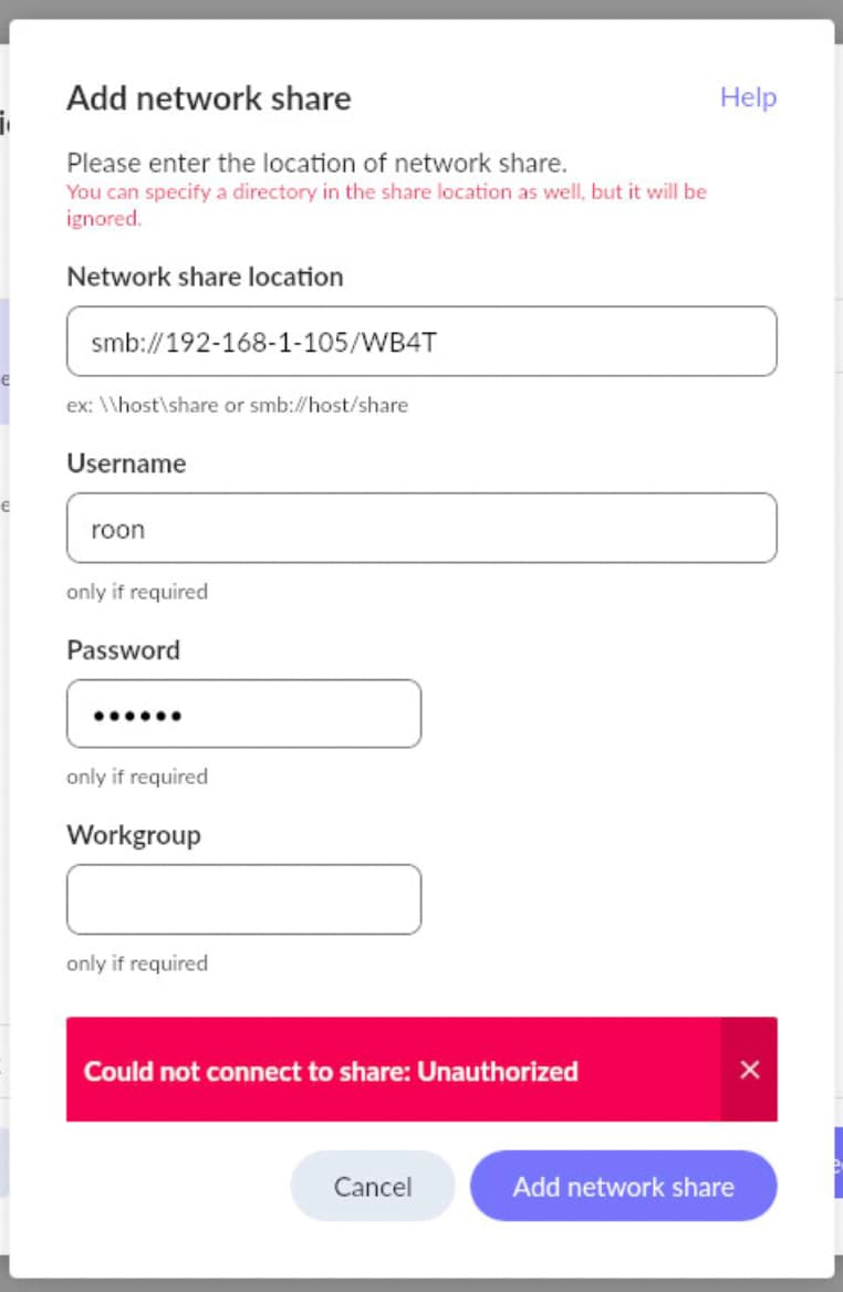

Coud not connect to share: Unauthorized
Roon Core Machine
Roon 2.0
Mac Mini
1.4 GHz Dual-Core Intel Core i5
Mac OS Catalina
Mac Mini running Roon Core (192.168.1.101) is wired to my router.
Another Mac Mini with my music storage is also wired to the same router (192.168.1.105)

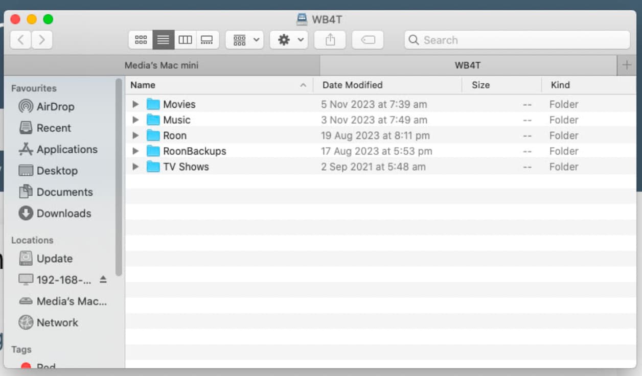

I want to add a network share to Roon. The folder with the music (WB4T) is attached to the other Mac Mini (192.168.1.105)). I set the Mac Mini to share that folder at smb://192.168.1.105/WB4T. I can reach that folder using Finder / Connect to Server.
But when I use the same credentials and address with Roon I get “unauthorized”.
Any idea on where to start to fix this?
Why are you using dashes instead of periods in the IP address in the network share location?
