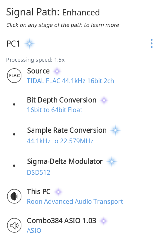

The next issue is how the DSD conversion is affected (crackling, glitching) by doing anything on the computer, e.g. switching windows.
I have a lot of stuff running, but the CPU is only at 30%, so this should be avoidable by setting up some buffering.
Any hints on that front? I already have the “Use Maximum Buffer Size” checked above.

A screenshot of your signal path leaving Roon when the issue occurs.

Any app really, but the intensity varies – more complex/heavy apps cause more crackling. Also any activity, e.g. compiling a Java program. Lowering the DSD from 512 to 128 makes the crackling not appear on app switching, but it’s still there on any heavier activity and occasionally in between.
Simple answer. Your Roon core computer is just borderline adequate for DSD512. Most non dedicated Roon core computers are not up to the task. And in your case, once other temporal processes add to the load, your 1.5x processing speed drops below the real time minimum.

Continuing forward, based on the processing speed in the screenshots of your signal path I have to agree with Andrew’s comment that the machine may not be powerful enough to handle DSD512. I would consider testing DSD512 playback via Roon on another laptop or desktop computer (if you can) that isn’t being used for " complex/heavy apps" as you pointed out in your post.
