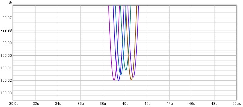

Here’s a picture of the variance I get…. Is this normal?
This is just taking the same measurement over and over again.

That’s a variation of about 2 microseconds between measurements which is less than a millimeter. This is normal and actually a great achievement by John given the clock deviations caused by the USB mic interface. The only way to remove even that kind of deviation is to use an analogue measurement mic with a microphone amp.
