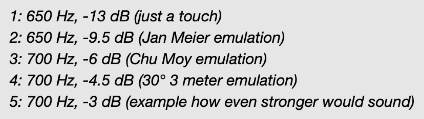

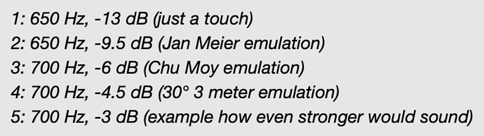

Other resources I found on crossfeed always have the feed level at negative dB. From head-fi.org
Here it is quite apparent that the lower the dB number the lower the crossfeed effect is supposed to be. Jan Meier’s setting with -9.5 dB is supposed to be a very minimal crossfeed implementation.
But, in Roon and ARC Jan Meier has a positive dB of 9.5 and would be similar to ARC’s High setting with a feed level of +9 dB or above.
So what is going on? Are these settings in Roon and ARC turned upside down or am I missing something?
